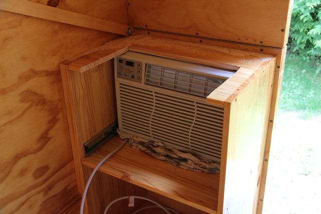

We tried to camp out in the Winter Warrior Friday night... problem was, the AC wasn't cooling the trailer down.
So Saturday we picked up a new window unit, and installed it into the WW.
Saturday night we grabbed our ballast (beer) and the dogs, and settled down for a long summers nap. But the new AC didn't cool any better than the old one did. The AC would run for a few minutes, and then cycle out.
What the heck?
So feeling around in the inside of the box where the AC is installed, the sides were cool, but the top was really cold. So is there a sensor in the AC somewhere that is picking up the temp inside the box?
Let's find out...
I cut a big hole in the top of the box.
Immediately the AC ran longer! So now I am thinking about cutting the right side of the box off too.
Did anyone else have this problem? I seem to recall that Len built something similar in one of his filon covered trailers...

Okay, I cut off the side... air flow seems pretty good now... Let me monitor it for a while and I'll let you know if it's any better...

Mike - is it possible the lack of air space was causing it to get so cold that ice was forming (or a sensor thought it was) and it was shutting down and re-cycling? This is not uncommon for heat pumps (when in cooling mode).

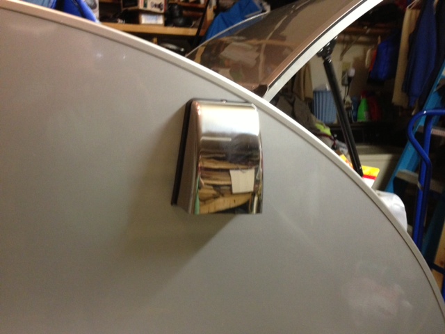

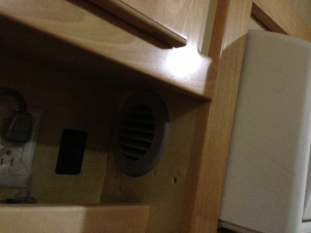

Mike, here's some pictures:
Prophetstown SP June 2013.jpg (113.3 KiB) Viewed 1594 times
Another view of Angel Wing.JPG (92.59 KiB) Viewed 1594 times
Better pic of interior AC vent and fan switch.JPG (90.74 KiB) Viewed 1594 times
The "Angel Wings" cover a 4" simple round vent like what you'd find on a shed. Behind the Angel Wing is a 6" plenum that goes the full width of the TD and the full height also. You can see the round vent next to the A/C unit in the cabin, with the plenum fan switch near it. When you turn on the A/C, you're supposed to also turn on the fans so the warm air is exhausted through the Angel Wings (as you're driving along, the side view of the covers look like Angel Wings).
I'll post a picture of the A/C in the wall on the next post....only 3 pics allowed.

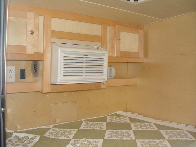

Postby Verna » Sun Aug 11, 2013 5:07 pm
I hope this helps, Mike.

You were having a problem with feedback on the "cold" side of the A/C, whereas I had a prolonged bout with feedback on the "hot" side. These window units were made for more open conditions than we give them in little trailers , I guess. There is a sensor behind the filter that tells the unit when the temperature reaches the desired level...in your case, inside the box. I use remote sensors for my home window units, so that sensed temperature level is from the middle of the room, not right at the unit itself. In my case, the exhaust temperature was fed back to the unit too well, the heat transfer of the Freon was interrupted by being too hot, and the unit would cycle off also. Glad you fixed your problem so quickly...my fix took 2 months.

Mike, there should be a thermocouple visable in the lower louvers of the front of the A/C..this tell it when the return air is at temp and shuts it down, with yours inside the box, the air was coming out and immidiatly going back into the return section, causing your grief.

Mike, I can see how having the AC set back in the box a little could cause that problem, it would be intaking the cool air only from that box and not getting enough of the warm air from the rest of the camper. Now that you opened it up a bit, I wanted to suggest to get more separation between warm air intake and cool air output to get an AC unit like the last photo Verna posted where the cool air points up instead of forward. This might make an additional difference. Luckily, they are the cheapest ones available at the box stores and wally world too. Glad you are getting it sorted out!
