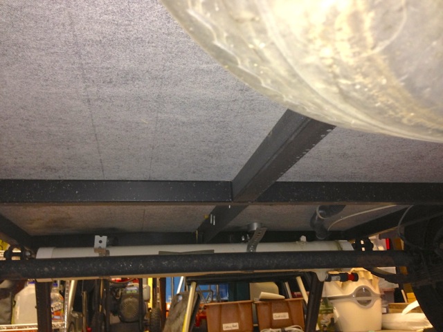

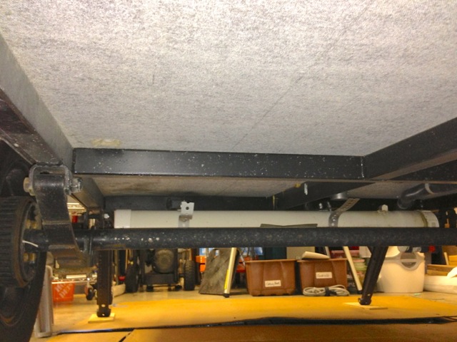

Postby halfdome, Danny » Fri Sep 20, 2013 8:58 pm
Thanks Miriam,
Here's a picture.
:D Danny

Re: Pondering moving Battery under the frame
Postby hwitten » Fri Sep 20, 2013 9:12 pm
Wow, that does look good. Thanks for the pic.
Since this is an after build mod, I'm wondering if I should get the initial verticals welded on or if bolts would suffice. Bolts would be much easier, as I don't weld but am concerned about drilling in the 2x2" cross member so as not to jeopardize integrity of the frame re strength. Any thoughts?
Postby KCStudly » Fri Sep 20, 2013 9:13 pm
Get it welded.
Postby doug hodder » Fri Sep 20, 2013 9:23 pm
I'd weld it, but then I have that capability. I really don't think you'd have any issue with bolting it up however. In a 2x2 angle cross member on a frame and weight of that size it should be fine. Others opinions may vary. The longsills on the frame are more prone to failure with holes as opposed to the cross members. Doug
Postby KCStudly » Fri Sep 20, 2013 9:36 pm
I assumed "2x2" meant square tube. If it is tube and you bolt it there is the possibility/likelihood that the tube will crush some, either by tightening the bolts or later due to the weight of the battery working on the bolts. It would therefore be preferred to have anti-crush sleeves (tube or pipe with ID that suits your bolt size) welded in. Since this, too, would require welding, I just cut to the chase and suggested getting it welded.
If it is angle it would depend on the thickness of the material. If it is thin 1/8 inch, I would think twice about hanging a heavy battery load cantilevered off of it. L2x2x3/16 or 1/4 thk would make me feel better about it.
Postby doug hodder » Fri Sep 20, 2013 9:45 pm
Good points KC...it's tough for me to really make a call on it since I don't know the length of the cross members that he is attaching it to or the details on the existing material, or if he is even wanting to attach it to a cross member. I just took a shot at it based on my experience. Doug
Postby hwitten » Fri Sep 20, 2013 10:36 pm
Excellent assumption re the 2 x 2 square. That's what it is. Total width is 55 inches between wheels. I'm going to go with welding. Maybe add a stiffener if I add the batteries in the middle so as to keep the batt cable short. Found the Battery Box at Jegs. Alternatively I may mount each Batt Box closer to the outside and use a #1 or #2 wire to connect the 2 x 6 volt in series.
