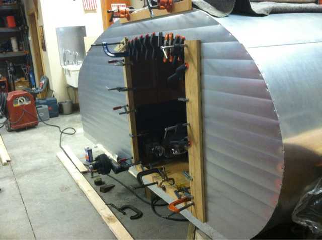

Postby Sputterputz » Sat Sep 28, 2013 6:26 am
I ordered mine through dexter parts online. It took 10 business daysfrom date of order to it being dropped off at my door. Called and spoke with Gordon and Justin a couple times and they took all my info over the phone emailed me a work order proof to sign and return via email and we were off and running. I had zero complaints. This was my first axle I had custom ordered but not my first trailer experience (we own a construction co, and have a few trailers that need parts from time to time)
You need to know a few things before you order,
Your estimated weight fully loaded. This is hard to guess if you are starting with a frame and building on top. I build my box first and made the frame to fit. I figured since I was fabricating an axle anyway it can be made to fit what I need.
Second are you going to have skirts that cover your frame? I was so you need to account for this not only in your box build but the axle width.
My box is 60" outside. I made my frame 58" wide to allow me to have a 3/4 skirt on either side w some wiggle room and dry air space.
The minimum hub face offset on my axle (dexter 9 _ 2000lb axle w 1600 rubber with brakes low side mounting brackets) is 6.5" per side or 13" overall that means my hub face measurement was going to be at minimum 71". The wheels I had picked had a backspace of 3" which was t enough to worry about side wall clearance but it was enough to get me out of a 8-9" fender comfortably so I ended up with a 74" axle and 11.5" fenders.
Hope that was helpful and not headscratching
