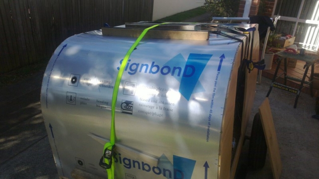

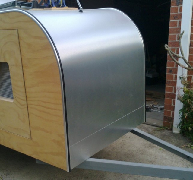

I can recommend an Aluminium Composite panel. It is 3mm thick with a resin core sandwiched in two alloy skins. It is light and has better insulation that just metal. I found it extremely easy to cut and fasten single handed. It bends very easily and has less "spring back" than most materials. The edge fastening is hidden under the corner extrusions and plastic insert plus I used construction adhesive at all contact points.

I should clarify that the aluminium composite I used is not used to cover a plywood roof, it is instead of a plywood roof. It is placed directly on to the roof spars. Once fitted no further finishing or weatherproofing is needed.
It is reassuring to know there is no plywood to rot under a failed resin or paint or metal top membrane.

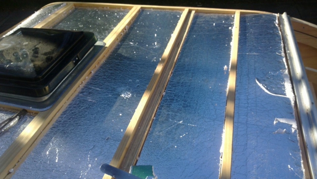

Ah, yes, I "cheated" a little. Maybe I will regret it later but I felt there was less need for side wall insulation in the climate I anticipate. I opted for solid plywood sides and will line the cabin with marine carpet to reduce condensation. The roof on the other hand is well insulated against heat ingress having the aluminium composite followed by a 20mm air gap, a reflective foil surface (foil will not work without an air gap), 25mm polystyrene then 2mm "bendy" plywood
