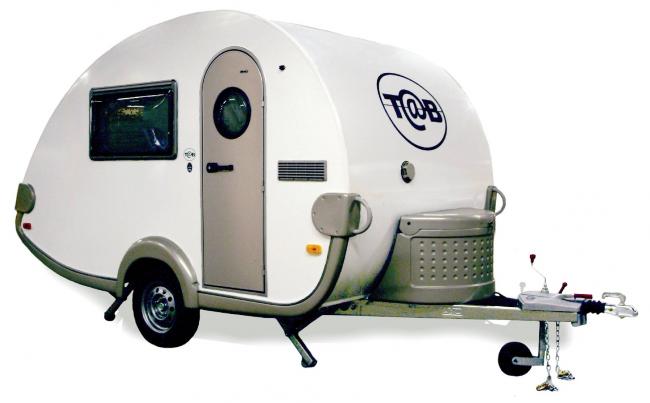

Postby mikeschn » Fri Jul 30, 2004 2:51 pm
Yes, the T@B is still in production. It's a relatively new animal having only come out last year or so...
The first ones were plagued with quality problems. I don't know if they've fixed that. They had a suggested retail price of $16,000, but last I heard, some RV dealers were dumping them for as low as $8,000.
They are not considered a teardrop because they are big enough for an average sized person to stand in them, and because the kitchen is on the inside.
A classic teardrop is typically only large enough to sleep in, and has the galley in the back. Oh yes, a classic teardrop has sort of a teardrop shape too.
