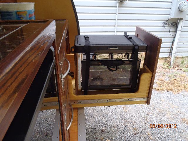

I seen a picture on here a while back, but can not locate it at this time. It was a picture of a pullout shelf that someone had made for a Camp Chef Oven. It had a storage area on the back side of the oven for spare 1 lb propane bottles. Does anyone know where to find this photo. Also feel free to share your picture of how you installed your Camp Chef Oven in your galley area.

The crowswing crowswing album has several pictures of their Camp Chef oven drawer. I do not know how to post any of their pictures. Halfdome Danny has his Camp Chef oven on a slide out drawer too.
Elizabeth and hubby (CrowsWing) have a tall drawer front that encloses their oven when the drawer is closed. With a fully covered drawer front it might need to be deeper (longer) to provide room for the "wind wings" as I think of them to fully open in front and back (or side to side).
CrowsWing YouTube
Danny has a shallower drawer (not as tall) and one end of the oven is exposed when the drawer is closed. It may be shorter too.
I have a Camp Chef oven and my set up will be similar to Danny's. I plan to build a drawer for the oven that is 24" deep by 18" wide and probably 4" tall. I figured the galley compartment for the Camp Chef needs to be 19" wide for the oven with a 1 pound propane bottle attached to fit into it. Plan to use 1-1/2" overtravel drawer slides KV 8505 24" Full Extension +1.5" 150Lb so the wind protectors on each side can be fully opened (they stick out at an angle) when the drawer is pulled out to use the stove/oven.
The Crows Wing's Camp Chef Oven drawer has a high back behind the oven. A drawer like that would need to be wider for the oven and gas bottle to fit inside it.

Esteban wrote:The crowswing crowswing album has several pictures of their Camp Chef oven drawer. I do not know how to post any of their pictures.
Here's the picture of Crowswing oven drawer:
