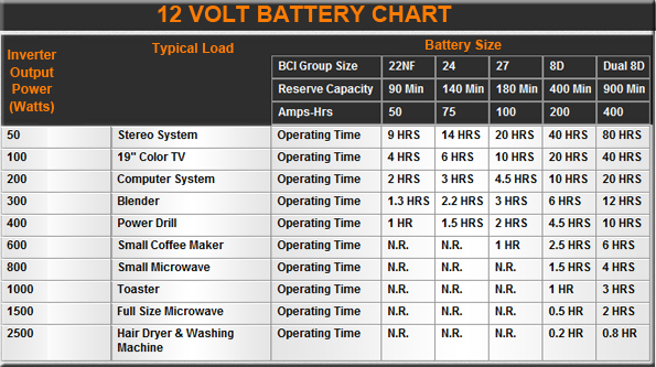

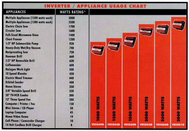

I have a 410 watt Schumacher inverter for use in my trailer, to convert battery power to 110vac, only if necessary when externally sourced power is not available (I also have an onboard 2500 watt generator-noisy-as another alternative). I've used inverters rated at 400-410 watts in all my vehicles for years, for small item usage like a work light (prior to LEDs, an incandescent shop light worked best) or even a 3/8" drill. I still use one in my HHR Panel to power a small heater (200 watts Lasko) and to charge power tool batteries occasionally. In the trailer, I have the 410 w inverter to power the same small heater, or LED lighting, or even the 10" 110vac fan. But since the inverter only is about 85-90% efficient, and the drain on the battery is so great using the fan or heater (over a long period of time), I only will use them in moderation. If you choose a larger inverter (needed for a coffeemaker or electric cooking device), then the 12v battery will be drained even faster. Here are a couple of charts to give you an idea of wattage drain and battery life:
Tailor your inverter size and length of appliance use to fit somewhere in the ranges given. Also, make sure your inverter isn't always on-line (either disconnect manually or by a switch) to your battery (whether turned on or not, the inverter draws power anyway); I didn't know that, and had mine drain my Optima to an almost dead state.
