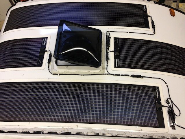

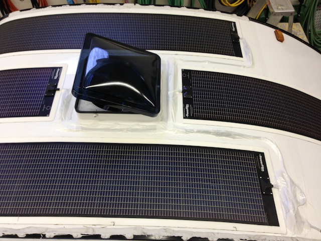

I now have 70 watts on the roof. Hopefully that will do me as my usage is actually quite minimal, primarily the Engel fridge that lives in back of TV.
I found some wide tape that actually matches quite closely. I'm going to try it as it does allow for a bit of hiding of wiring. The downside of a store-bought vs built-ur-own, much more exposed wiring, etc.
First trip will tell if I will try and leave it on. Tape is only for looks but it might serve to protect a bit too as a bonus.
I just hope all the wiring and connections are good. Will have to wait until a day in the sun I guess.
Wiring in the raw.
Wiring covered for perhaps a bit better look.

Installation went good and relatively easy. Just had to make sure roof was clean. I used some painters masking tape to outline so that I'd have a better chance of being straight as once it's on.... it's on. Used a rolling pin to apply even pressure. Had done one side earlier as the manufacturer "forgot" that I wanted 2 panels. Made me a bit braver to try this latest tweak.
The PowerFilms are not cheap but are "supposed" to be more efficient in less than ideal conditions. Solar is a bit of a black box, really hard to test. I'll report on it after next trip. Maybe earlier if I get restless and yank it out on a nice day.
