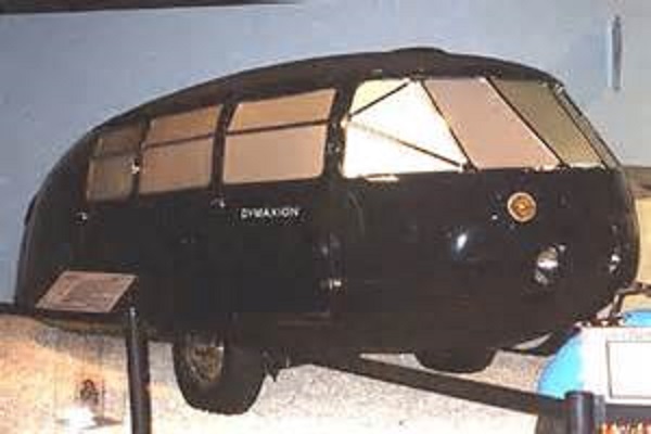

OK, let's set the parameters. (a) Form: Teardrop, or TTT (any historically seen profile)- or cargo or foamie (not really classic-yet)***side note: standies , canned hams, and similar are "classic", but in another category than TDs & TTT's, (b) Size: 4x8 minimum 6x12 maximum (actually, I've got an informal average size of plywood trailers, from about 100 samples of the most prevalent types: 5x9 and 1050lbs), (c) Internal features: (depending on size and profile limitations) must have some galley or storage for "cooking gear", water, and minimal "potty" equipt., sleeping arrangements for a couple or +kids, venting/windows/fans/insulation for Mid-American climates (everyone needs air, whether its hot or cold) temp range 10F- 95F (about 40 degrees +/- from average national temperatures). Here's a factoid: State-wide averages of annual temperatures range from a high of 70.7 degrees Fahrenheit (21.5 degrees Celsius) in Florida to a low of 26.6 °F (-3.0 °C) in Alaska. For the entire United States, excluding Hawaii and Alaska, the year averages 52.7 °F (11.5 °C).The temperatures are based on data collected by weather stations throughout each state during the years 1971 to 2000 and made available by the NOAA National Climatic Data Center of the United States. Taken from http://www.currentresults.com/Weather/US/average-annual-state-temperatures.php. It looks like A/C and heat are the new normal equipment for us now, "classic" or not. And insulation is also feasible now, though not traditionally "classic". and (d) Covering/skinning/painting: "classic" almost dictates aluminum, but that was what they had available during the golden age of teardrops. Now we have many choices, unavailable before, or better than back in the day. Still, the aluminum skin is the "classic" approach. If you really want a different "classic" TD or TTT to celebrate with, why not design a moderately-sized 5x9 (or thereabouts), aluminum-skinned (or appearing) adaptation along the lines of a Bowlus
Bowlus Road Chief.jpg (62.38 KiB) Viewed 899 times
or as a Dymaxion look-alike
Of course, to do so, the foamie techniques of curving and canvassing might be utilized. Whoops, crossing lines here! I guess that means you're free to create a new "classic" standard!
