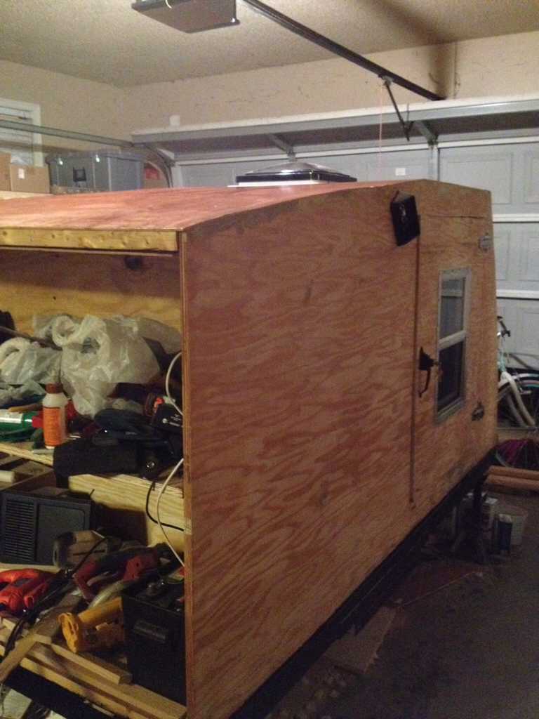

I have done TWO coats of CPES on the Luan front and top exteriors.
And I've done ONE coat on the 3/4" marine grade plywood exterior.
1. Is that enough CPES?
2. How will I know it's coated well enough?
3. When is it ready to paint?
4. Can I take it out and try it out WITHOUT paint on it and just the CPES?
Please try to answer each number question for me. I get so much good info from this board! Thank y'all!

1. On my teardrop floor, I applied 3 coats of CPES. On the third coat I noticed the epoxy "building up" and filling in the grain/pores of the plywood. If you have enough CPES I would apply 3 coats.
2. You should notice the CPES not being absorbed - sitting more on the surface - and the grain being filled.
3. Don't paint before all of the solvents "gas off". If you can smell any solvents it is too early. Also, I don't know if it is from the solvents or the epoxy diluted in the solvents but there is an oily finish that stays on top for a week or so. I waited until most of that dissipated before I did anything. You may want to try to remove it using acetone on a rag. Before you paint I would very lightly sand the surface to give the paint some "tooth" to bond to the CPES coated plywood.
4. It's okay to take it out - I let my teardrop "bake" in the sun, but you wouldn't want to camp in it until the solvents dissipated.
