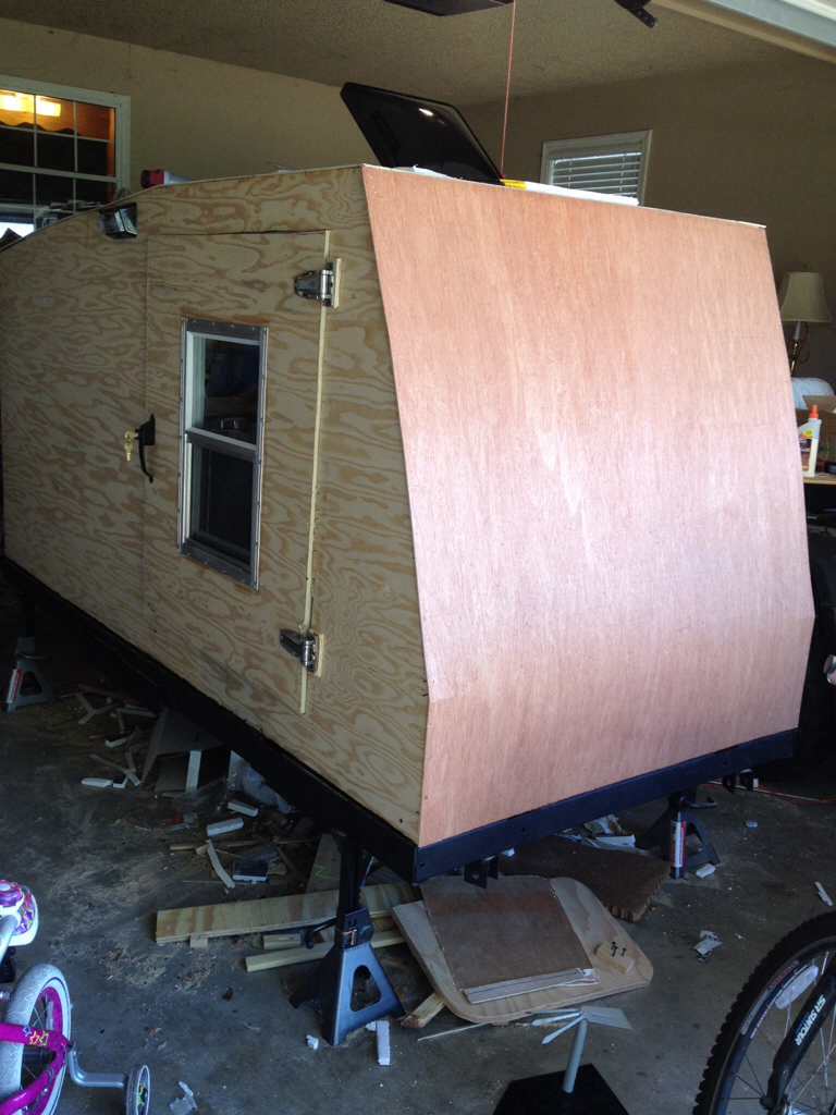

1. What tool do I use to cut 1-2" off of my hurricane hinge?
2. How do I cut a few inches off without messing up my hinge?
