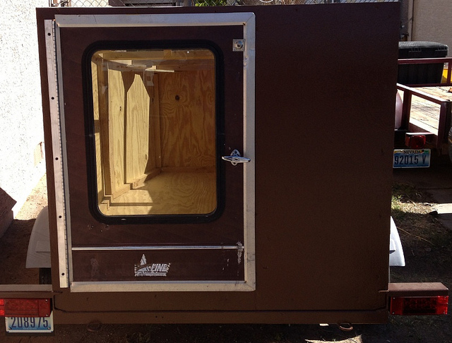

I bet the title doesn't even make sense. It's hard to explain. I have a vertical door (as opposed to a horizontal hatch) at the back of my camper. It swings on a piano hinge. if I let it, it will open to 180 degrees. But that would stress the mounting, and there's a whole host of other reasons I don't want my door to open that wide. I'd like the door to open to 90 or 100 degrees and then lock there.
I've considered a gas strut, but honestly, I can't wrap my tiny brain about the geometry of the mounting points, and I think a gas spring might be TOO strong for this application.
Another idea is something called a "lid stay". It's something like you would see on a foot locker or a step ladder, to hold either one in the open position. I'm not convinced this is the best idea either.
What have some of you folks used to keep a door open, but not TOO open?

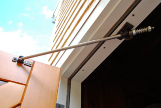

I looked at your build thread and saw this:
I would attach a stay at the top, like this:
door stay.jpg (18.78 KiB) Viewed 793 times
I forgot where I found this photo, but I've made my own stays before, much like it. Or, you could reverse (turn it upside down, mount on the right) the mounting of your door, to open to the curbside, then you could mount a "cushioned" stop, or mechanical "trailer door" door clip to keep it from overtravel. And, that would enable a larger free space at the rear when opened.

working on it wrote: I would attach a stay at the top, like this:
I bet you found that photo here:
http://realcarriagedoors.com/hardware-i ... neous#jump
Neat idea. Obviously that one is way oversize, but I might be able to make one like that.

The person called "working on it" gave me the idea. Of course, the ones shown in that post were for garage doors, way too big for my TTT. So I built one just like it, only scaled down.
Just some junk bits hanging around the shop, and about a dollar's worth of hardware. The wing bolt acts as a set screw, so the door can be "locked" in any position.
thanks for the idea, "working on it"!
