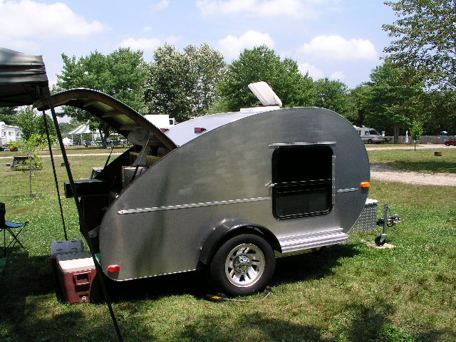

Jack, noticed a solar cell on the front cover, what size (amp rating) and how good does it work. Very nice tear, lots of good ideas.
It looks like that's a .3amp hour solar charger...
Found on the web...:
Rated power: 5 Watts
Rated current: .30 Amps
Dimensions: 21.8" X 9.71"
Weight: 1.18 lbs. Rated voltage: 16.5 V
Open cicuit V: 23.8 V
Here's how I figure that would work...
I use my lights for 2 hours a night. They draw 2 amps per hour or a
total of 4 amps per night.
Then to refill the battery, the solar panel inputs .3 amps per hour
back into the battery. I need a total of 13.3 hours of good solar
charging time to refill the battery. (4 amps /.3 amps = 13.3 hours)
P.S. You definitely want something much larger... I would start looking in the 35 watt to 50 watt range...
