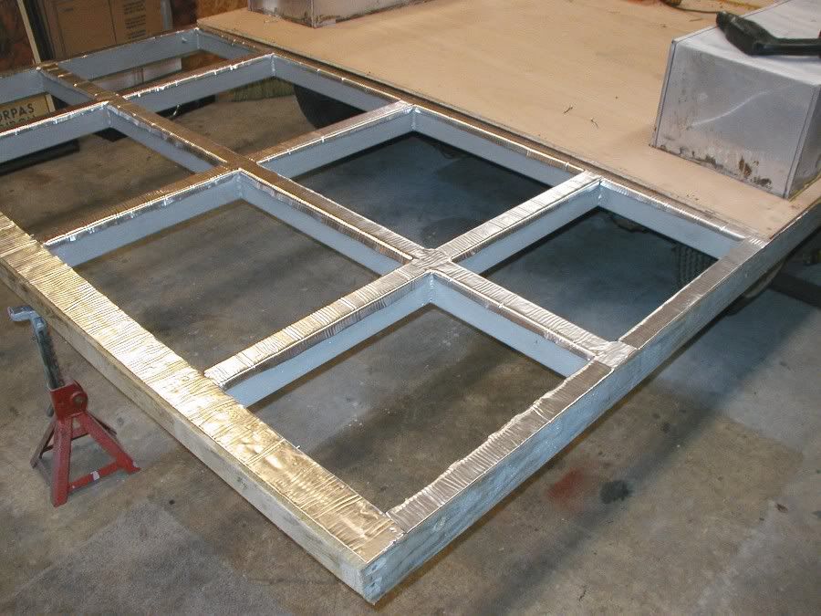

Postby 48Rob » Sat Feb 15, 2014 7:03 pm
Pretty common, both today with home builds, and in the past with teardrop and travel trailers/trailer homes.
Here is a picture of a 1948 trailer that I redid using 1/2" plywood, as original.
The silver material is to seal the metal/wood contact area.
