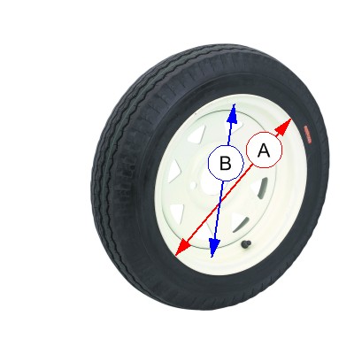

Roly, are you fitting the disc to the outer flange of the wheel (A)? If that isn't perfect, I wouldn't be worried as it is the diameter and roundness at the tire bead seat (B) that will matter.

Yep, my disks on cut to the outer rim. I checked the roundness of both tires when jacked up, and they are almost perfect. No sweat.
