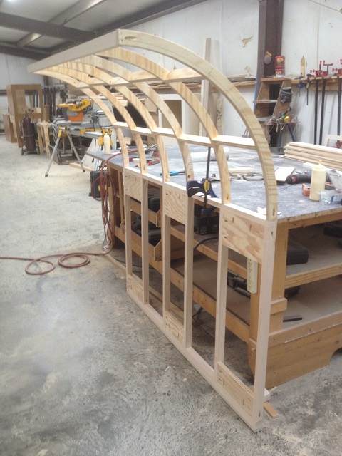

Thanks for the advise. I was thinking of formica in the first place but I've have enough scraps of 1/4" maple fibercore strips from work to do the whole interior. I have stick frame walls. I'm stripping the inside of my walls and spraying them at work the bring them home to put together. Were running out of room at work.This is the frame before I put stripping on it. 117044

Postby KCStudly » Sun Feb 23, 2014 10:31 am
Nice work. :thumbsup:
