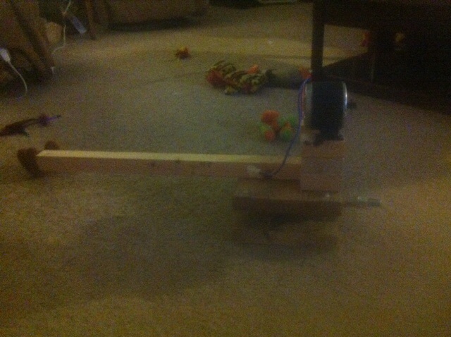

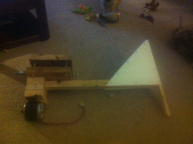

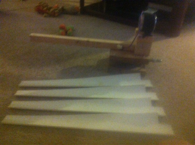

I couldn't buy the stuff to finish my teardrop today so I worked on my power supply.
I want to try a wind turbine and solar cell combo. I started the turbine today. Here are some pics.
Keep I mind this is the 1.0 model.

Postby pyro22487 » Mon Apr 21, 2014 12:14 am
I wanted to make sure you saw the first picture at least 3 times

Postby Micro469 » Mon Apr 21, 2014 4:25 pm
So now that everyone has commented on your pictures........ can you explain a little of what your doing? I think the motor is sitting on the base and can swivel, and the bottom pic shows the tail, am I right? Tell us a little bit about the motor your using, and what you expect the output will be. I know nothing about turbines, so every little bit of info is helpful. How are you planning to mount it when camping? looks like a koool project.

Postby pyro22487 » Mon Apr 21, 2014 5:58 pm
Well without the hub it's kinda difficult to explain but the generator/motor is mounted on the bottom a chain will run from the motor to the turbine hub. There will be a swivel mounted on the bottom. Once I have it balanced I will know where. The motor I used is a 2500 rpms at 24 volts at around 8amps. I'm not sure on the amps.
The motor needs to spin extremely fast for this to work close to 1500-2000 rpms at those speeds it will have around 15 volts and around I think 150-200 wats of power. To make it spin this fast we are using a 1-8 gear. That is a 6" 80 tooth gear attached to the prop and a .75" 10 tooth gear attached to the motor.
The motor came out of a small electric scooter it had the gear the chain and the motor all right there. Craigslist score 30$ for 2 scooters. The blades are PVC pipe the rule for making pipe blades is 1-5 ratio so for every 5" long you need 1" in diameter. I used a 6" PVC and the blades are about 30" long. You cut the pvc into 4ths and just cut an angle on one side. This will give you 4 blades and most turbines use only 3 so you have an extra.o
