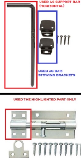

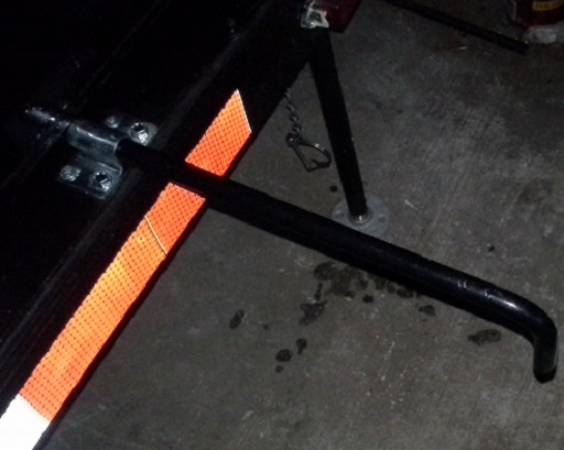

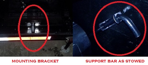

working on it wrote: I'll also re-engineer my stabilizer brace, to better withstand incidental contact (as when tripping over a ladder!).
* Looking over parts that I had bought, but ended up not using on the trailer, I found a "barrel bolt" and a "cane bolt" amongst them. I used the receiver piece from the barrel bolt, and all of the cane bolt set. The bolt receiver became the support's mount, the cane bolt became the removable support bar, and the brackets to the cane bolt now hold it on the sidewall, when stowed away.

* The cane bolt fits the barrel bolt receiver perfectly, and the generator slide-out is a friction-fit on top of it. Easy to assemble, easy to use, easy to stow away for travel. Money already spent = free parts now! I'll paint the zinc bracket and TEK screws black, to match.
