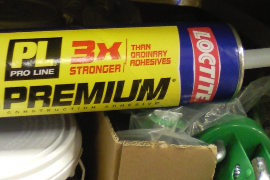

Postby ddupre » Sat May 17, 2014 3:40 pm
Will this stuff work?

I really recommend following the manufacturer's instruction on this one.
http://www.menards.com/main/store/20090519001/items/media/Wallcoverings/pioneer_plastics_wall/Install_Instruct/07_FRP_Installation.pdf
I have had really mixed results using tube-type adhesives on FRP. The instructions are quite specific, and if you were to get the same coverage, it is a lot cheaper to use the stuff they tell you to use. FRP has quite a bit of expansion and contraction with heat and cold, and many adhesives do not have the elasticity to handle the changes.
YMMV
