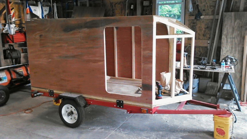

Postby jrjr » Fri Jun 20, 2014 4:57 am
I have gotten my build started. Here's a pic of the progress. A friend gave me a big roll of nylon material which kind of compares to 7oz canvas in weight. Maybe a bit thinner. I plan to do some testing before actually putting it onto the trailer but I was wondering if anyone here has experience using nylon. Would it be best to adhere with TBII or paint? I got a couple of gallons of the old, real oil base paint to use if I want. Should get the testing started today. There isn't much info on using nylon on here. I have read some comments that ballistic nylon would be the strongest but no application history or results.

Postby GPW » Fri Jun 20, 2014 5:47 am
That’s looking Very Nice !!! :thumbsup: 8) :D
