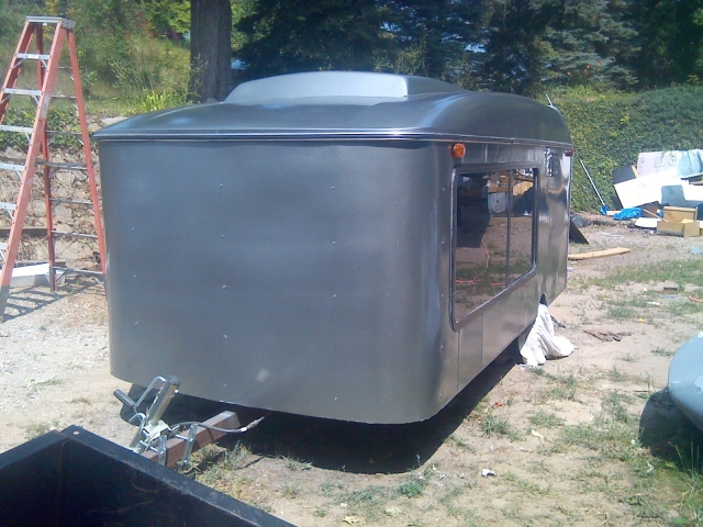

Postby Sidekick » Wed May 28, 2014 8:24 am
Having built several boats and other projects I know how hard it is to weatherproof seams. Tghat is why I am starting out with a weather prooftop taken off of an old coversion van. It has some nice curves and should look spiffy when the package all comes together.
Total spent to date
Fiberglass topper- 50.00 local pick and pay
axle- 0 ( donated by one of my friends)
frame metal -78.00
wood for floor 34.00- Home Depot
wood for framing- free ( taken from crated a/c units at past job
Lights- 32.00
wiring- free ( left over from Dune Buggy fab
switches- 6.00 off ebay
Inverter- Donated by my father
The adventure begins
I am calling the trailer RERUN because it is mostly made up of salvaged pieces and parts giving them a new purpose..
Once I figure out how to upload pictures I will post them

Postby Sidekick » Wed Aug 10, 2016 5:55 pm
122970

Postby aggie79 » Thu Aug 11, 2016 9:30 am
48Rob wrote:Looks pretty cool from here! :thumbsup:
More pictures please...
Rob
I'm with Rob. That is a very nice build. In looking through your gallery pics, the interior looks like you covered the walls and ceiling with carpet (or hull liner or speaker enclosure fabric.) How'd you frame the walls?
Take care, Tom
Re: Rerun
Postby Sidekick » Thu Aug 11, 2016 5:46 pm
The trailer was framed with 2x2, lined with 3/4 foam then inside skin was 18 in hard board with decking carpet glued with scotch 77 high bond. Makes it nice and quiet inside

Postby Sidekick » Thu Jul 13, 2017 6:06 pm
There are plenty of pics that I have posted of the build. The trailer has survived 2 years of use with only a rear hatch problem that was easily solved. I am on to my second attempt
