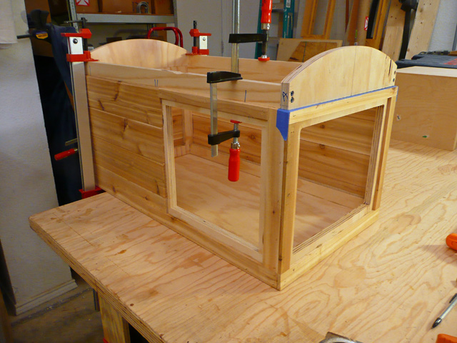

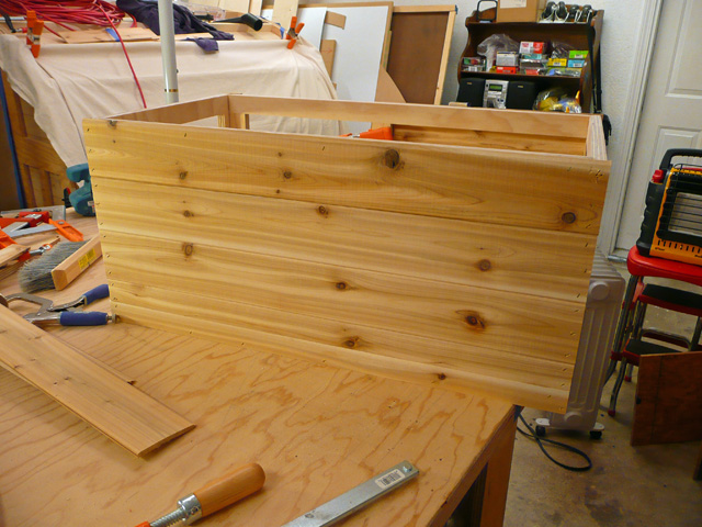

I built my tongue box using 3/8" tongue and groove cedar wainscoting over plywood framing.
First I constructed the frame. Then I applied the cedar.

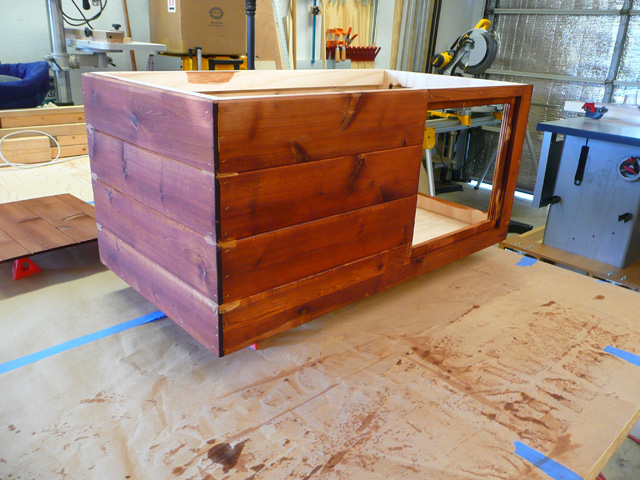

To give the wood an aged look, I applied TransTint wood dye on the outside of tongue box.
After several days to allow the water to evaporate from the wood dyes, I applied 3 coats of epoxy on the inside and outside surfaces. I then applied the aluminum edge moldings and primed and painted them black. Lastly I applied 3 coats of EmTech 9300 from Target Coatings to provide UV resistance.
