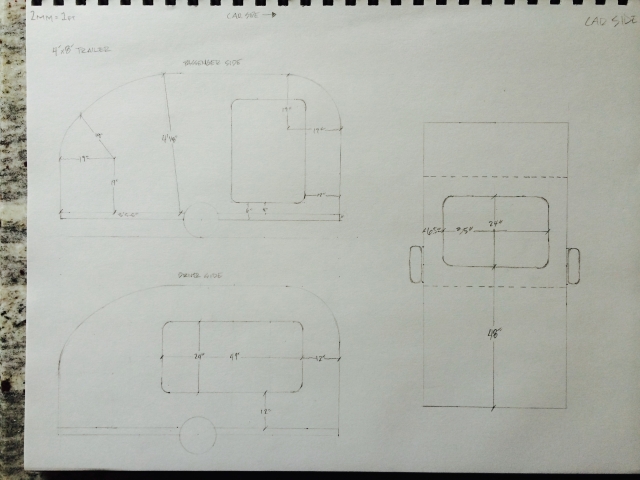

Thanks for the responses! Here is what I have drawn out so far:

I may be off here, but that window looks like it is a regular frame, with a regular trimmed glass panel, only installed fixed instead of with the mechanism to open. It still has a seal around it, and it still appears to have weep holes to drain it. Mounted flat, the trough between the outer and inner frame would fill with water, and only the rubber seal would be protecting you from Niagara. And, that seal isn't intended for that. I think you could probably set that window into the frame with lots and lots of aquarium caulk, and make it work, but I don't think it would work out-of-the-box.

Before you sell yourself on a particular window/size, you might want to create a more accurate scale drawing showing the correct sized wheels, and fenders if it will have them, to be sure they won't interfere with your windows.

Postby grant whipp » Mon Jun 09, 2014 8:30 pm
48Rob wrote:Before you sell yourself on a particular window/size, you might want to create a more accurate scale drawing showing the correct sized wheels, and fenders if it will have them, to be sure they won't interfere with your windows ...
And, if you will be having a galley & cabinets in the back, you'll need to move that axle back toward the rear quite a bit more. The general rule of thumb is 1/3 of the body length from the rear of the body, so on a 96" long body, the axle centerline should be about 33" from the rear of the body.

I followed the link to the window for the roof on EBAY. I do not think that it will work for the roof. If you look at the expanded view you can see weep holes on the windows on the pallet. The windows are upside down on the pallet so in the picture the weep holes are on the top. What you need for the roof is a sun roof for a full size van.
