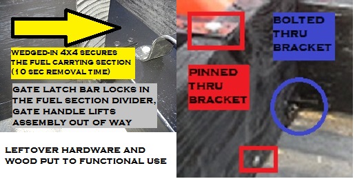

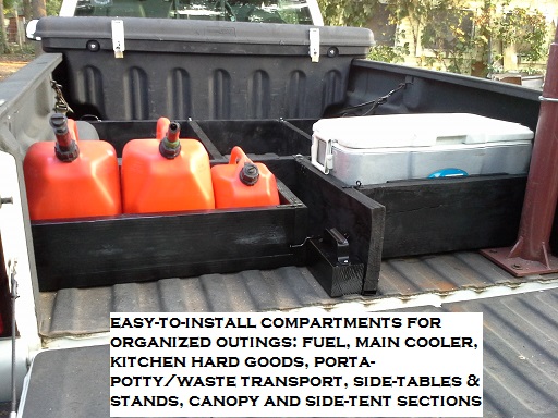

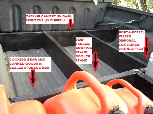

OK, my trailer has a weight problem...as noted in this thread, http://www.tnttt.com/viewtopic.php?f=2&t=56787&p=1086016#p1086016 and this one http://www.tnttt.com/posting.php?mode=edit&f=21&p=1088085. I am attempting to reverse the trend of constantly adding weight, by moving some items to the bed of my TV. Using my bastardized version of angib's immensely useful balance formulae as a checklist, I moved 147 lbs from the trailer to my pickup bed, and still maintained 9.9% tongue weight (down from 10.3%). Since I use a weight distributing hitch anyway, no difference should be apparent during travel. The main object of this exercise is to make the trailer more easily/immediately usable upon arrival at a campsite. Previously, I would have to load and unload tent, canopy, a heavy cooler, side-tables, cookstand, chairs from the interior of the trailer (I designed it that way, but empirical data wins over theory here). I am getting older, and lazier too. I want to be able to remove one or two items from the cabin and be able to hunker down immediately, especially after dark or in inclement weather. So, I moved weather resistant items to the bed of my truck (lacking an enclosure like a topper or large SUV; my HHR would've worked fine for this, if I had built at 1/2 the weight!). I had already built a compartment to transport my cooler (back when I was dragracing) about 8 years ago; it worked fine to keep the cooler locked in place, while I packed miscellaneous racing gear around it, and also served as a secure transport for fuel from the gas station to home. I repainted the treated wood, and refreshed the hardware, then added more sections to transport my camping gear. A place for everything I moved, measured and built to fit each piece. Truly a redneck engineering design, but I'm still working on it.

I made something similar to this (since disassembled and the lumber used elsewhere). When I made mine, I used 2x lumber that matched the height of the wheel wells which allowed me to place 5 foot wide materials flat in the bed (my F150 has about 49 inches between the wheel wells). I often thought that with the addition of some plywood, it would make a great platform on which to place a queen size air mattress. With judicious placement of doors, the under bed area would provide plenty of storage.

WoodSmith wrote:I made something similar to this (since disassembled and the lumber used elsewhere). When I made mine, I used 2x lumber that matched the height of the wheel wells which allowed me to place 5 foot wide materials flat in the bed (my F150 has about 49 inches between the wheel wells). I often thought that with the addition of some plywood, it would make a great platform on which to place a queen size air mattress. With judicious placement of doors, the under bed area would provide plenty of storage.
