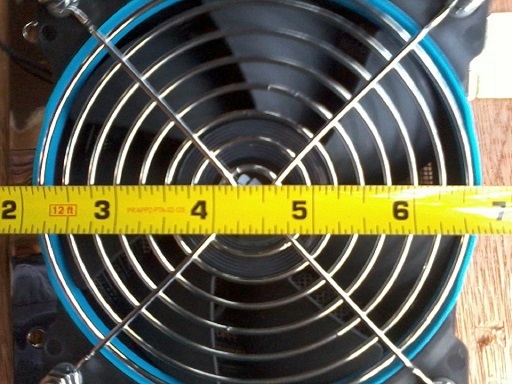

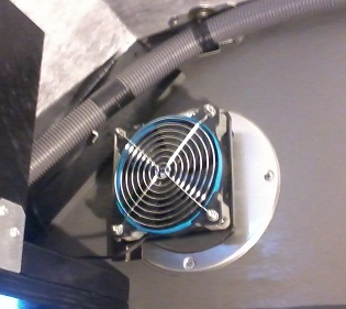

I installed two 120mm case fans (63 cfm each) on my side vents (screened, with butterfly closure), but never intended them for primary air circulation on a warm day. Intended mainly for eliminating humidity (and CO) in my air-tight 4x8. I have a powerful ac powered fan for that, and an A/C unit as well. The case fans will suffice once the sun goes down, and the temps fall. I mounted them on swing brackets (continuous hinge), so I could swing them away from the butterflys to open or close them, or, if swung away, they direct a small breeze towards the occupants. I installed metal finger guards on the usual face-out side (visitors or tourists might insert a finger, otherwise), but none needed if used for straight forward air-flow ( I won't insert a finger).

Nice looking fan and set-up. I like the finger guard. A guard is something that I should probably add to mine too.
