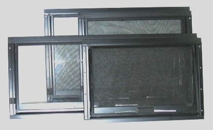

Postby working on it » Wed Aug 06, 2014 8:19 pm
lonestar_shawn wrote:Wow, thanks for the responses! I hadn't thought of the "awning" style windows, but that seems like it would be a big help. It also seems like with a good battery system I'd be able to run some computer fans at least some of the time. Does anyone have any sources for awning-type windows? Some google searching didn't turn up much....
http://www.teardrops.net/teardroptrailerparts.html
  • Li'l Bear Teardrop Side Windows
    part item #
    12"H x 18"W Screened Crank-Out Window
    Untinted, Black Powdercoated aluminum frames
    ________________________________________ Cost: $53.00 each,
    plus S&H
    12"H x 30 "W Screened Crank-Out Window
    ________________________________________ Cost: $61.00 each,
    plus S&H
    15"H x 18"W Screened Crank-Out Window
    Untinted, Black Powdercoat aluminum frames
    ________________________________________ Cost: $56.00 each,
    plus S&H
    15"H x 24"W Screened, Crank-out Window
    plus S&H
    15"H x 30"W Screened, Crank-out Window
    ________________________________________ Cost: $64.00 each,
    plus S&H
After two years of searching for my best option (took that much time to get to that point in my long, long, build), I finally decided on what many others had used for their windows ( I hadn't seen one in person, but relied on word of mouth references). And sourced from a respected member of this forum. I bought the 15"x18". Great window!
