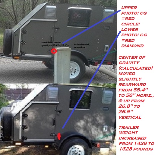

Though my trailer is not a true teardrop, and built with all angles, not curves, being a "SIMPLE" design
Dictionary.com wrote: sim•ple
1.easy to understand, deal with, use, etc.: a simple matter; simple tools.
2.not elaborate or artificial; plain: a simple style.
3.not ornate or luxurious; unadorned: a simple gown.
4.unaffected; unassuming; modest: a simple manner.
5.not complicated: a simple design
Personally, I don't see that my trailer can be defined as any of the above...., it sheds the wind on the highway, and so far hasn't been subjected to any high winds. But, it does weigh a lot (1628lbs at the present time), has a couple of 600 lbs (each) capacity stabilizers on the rear, and if still secured to the TV, has at least 5600 lbs anchoring it down. If detached, the heavy weight/compact size of the trailer, and the relatively low center of gravity,
centers of gravity, old & new.jpg (118.6 KiB) Viewed 1146 times
lends a measure of stability under most all conditions. Around Texas, we have tornadoes, microbursts, some straight line wind problems, squall lines, (and Blue Northers!), but nothing like the consistent high winds that people report of, from out West.
Hopefully, I won't encounter any bad winds, but you never know.
