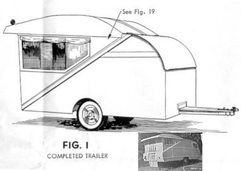

Slow, looking for something else, I came across this, which is almost exactly what you want. By taking a piece of the sidewall up with the hatch, the joint becomes a straight line that the sidewalls can be hinged from.
Neely Hall illustration.gif (210.1 KiB) Viewed 327 times
The plans are by a Neely Hall, but this is all I have.

Postby KennethW » Sun Sep 07, 2014 11:26 am
Here is my thought on the hard side. If the side is less then the width of the camper fold the side flat inside the back door panel then fold the back door panel up inside the hatch. One would lift the hatch a little higher then normal drop the back down. pull the side out past the wall then drop the hatch down to the camper walls. all hinged together with the proper over lap.
