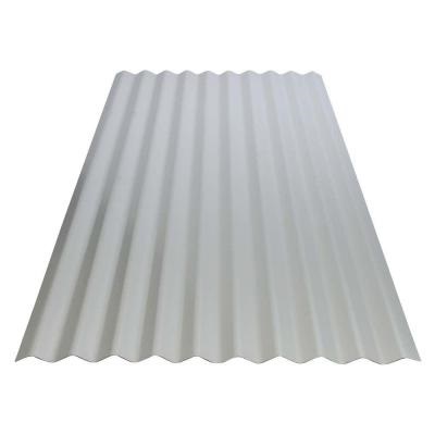

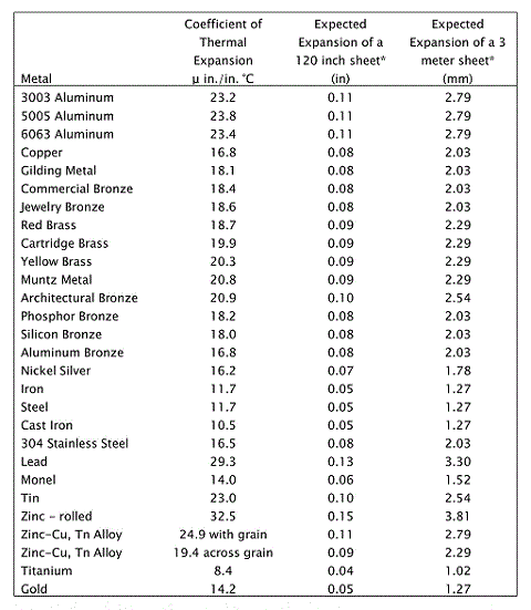

Not really a failure, but a bad choice of materials. Coroplast, as most plastics are, is greatly affected by heat, and the resultant thermal expansion.
  • for Coroplast, the Coefficient of Linear Thermal Expansion is
  • -30 degrees C to 0 degrees C 12
  • 0 degrees C to 30 degrees C 14
  • 10 to 30 degrees C to 60 degrees C 21
Compare the numbers in red to this table:
Given the heat of a Las Vegas (or Texas) direct sun on the flat plastic, or even aluminum sheet (also with a high coefficient number, there was inevitable expansion. If you note the high coefficient number for tin, 23, you'll appreciate why the term "tin-canning" is coined for this phenomenon. Also in the table, I see that a flat roofing surface of Titanium (C.O.E. of 8.4) would be ideal for your application, if not for the great cost. If you could replace your roof with a corrugated steel panel ($10 at Home Depot, for example), C.O.E. of 11.7 or so, as used by at least one other forum member, the expansion would be minimal. And when it rains, the sound is wonderful....
96x2.75 corrugated steel panel.jpg (13.5 KiB) Viewed 1147 times

Postby citylights » Sat Sep 06, 2014 11:34 pm
working on it wrote:. If you could replace your roof with a corrugated steel panel ($10 at Home Depot, for example), C.O.E. of 11.7 or so, as used by at least one other forum member, the expansion would be minimal. And when it rains, the sound is wonderful....
Nice! :beer:
