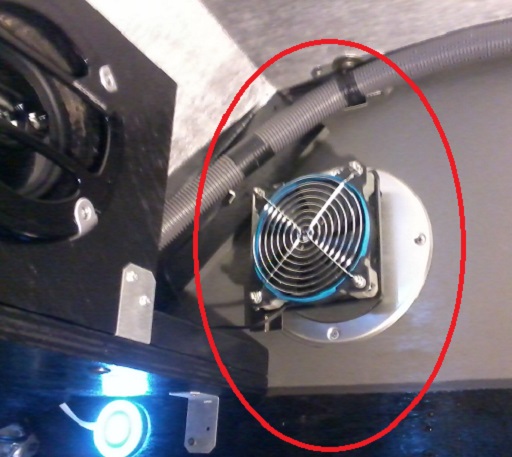

Postby Shadow Catcher » Sun Sep 21, 2014 6:45 pm
We have two Antec 80mm three speed case fans with a switch that allows one or both to be used. Ours is a large tear and seldom do we use the fans on more than middle speed here you see versions one and two.
5468279656
