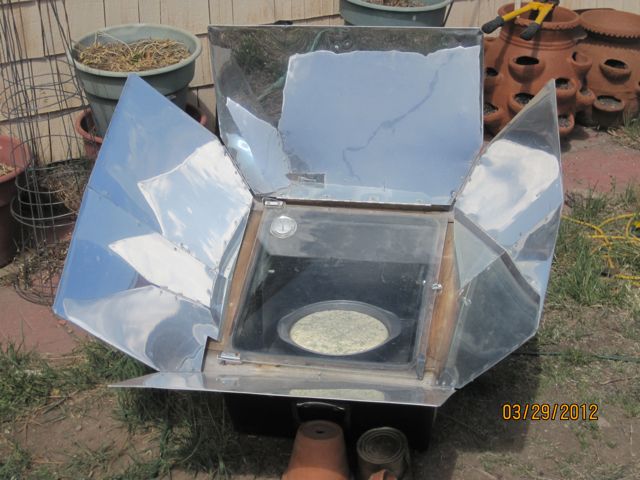

Several years ago I was working grave shift, and since I was home every day during daylight hours I did a lot of solar cooking. I have a home-made cookit http://solarcooking.wikia.com/wiki/CooKit and a Global Sun Oven, now bigger and better as the All American Sun Oven http://www.solarcooker-at-cantinawest.c ... _Oven.html. I'm at 35 degrees 53 minutes north (northern New Mexico, USA), 7200 ft above sea level, and did my cooking in October, November, and December. Oh, I do some solar cooking in all seasons, but that three-month period was my most consistent.
8)
With the CookIt, I used a blackened SS bowl in a clear glass (Pyrex) casserole http://www.amazon.com/Pyrex-Bakeware-2- ... ered+pyrex, creating a "greenhouse" cooking container. A similar, much larger vessel is used with the HotPot solar cooker http://www.solarcooker-at-cantinawest.c ... okers.html. I was able to get my rice dishes to boiling in October, but the Cookit is very touchy about breezy weather. It works, but now I use it only occasionally, mainly as a way to keep hot things hot, but not to get them to temp to begin with.
I was able to cook full meals and even bake in the Sun Oven even on Dec 26. My habit was to re-aim the oven one or two times an hour. In our cool, clear air, the oven was usually able to maintain a temperature over 300 F around mid-day with my aiming schedule, which meant I could cook a meal in a couple of hours, including biscuits or cornbread.
The Sun Oven also catches every breeze, but it has more mass and is less likely to sail off and dump a meal. That said, OctNovDec are relatively calm months here. I have had much more trouble with the Sun Oven when camping in the spring (Wind Season) and summer here, the months when we have fire restrictions in all the forests of the southwest and therefore could use the solar ovens! The sun is more directly overhead, but the wind blows more.

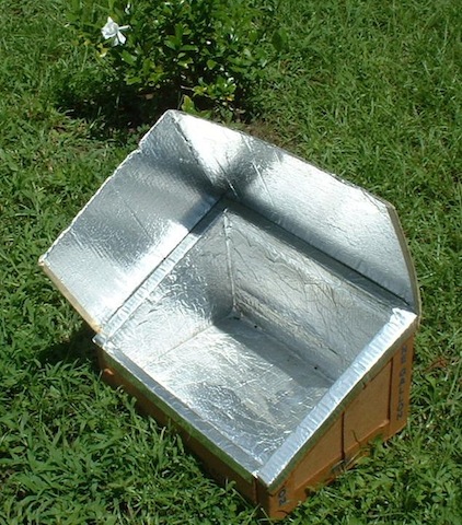

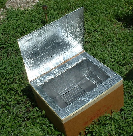

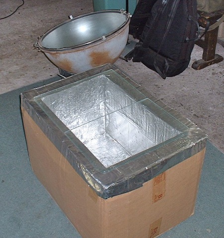

We’ve done lots of Solar cooking .... made solar cookers from cardboard boxes and tin foil ... all worked fine ... Cooking around noon worked best for us , and there wasn’t much to attend to since everything cooked in just a couple hours... :thumbsup: 8)
Re: Cooking with a solar oven
Postby GPW » Sat Nov 15, 2014 6:15 am

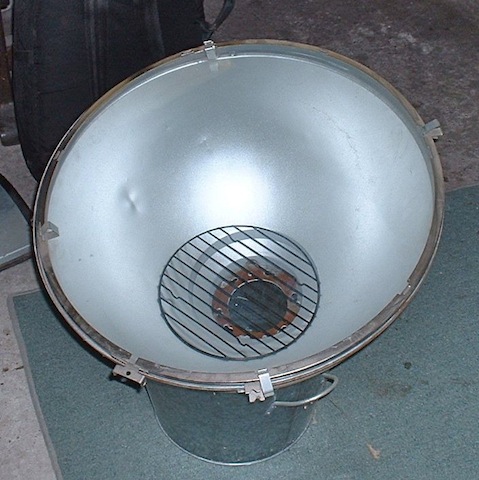

...and one we made from a discarded street light ... and a bucket ... :D
