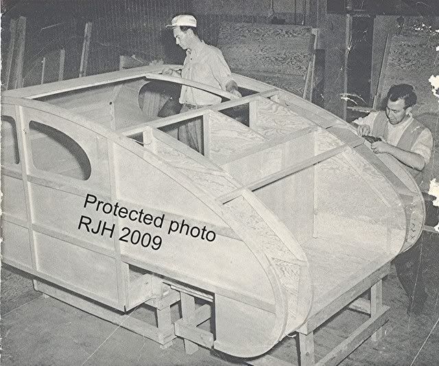

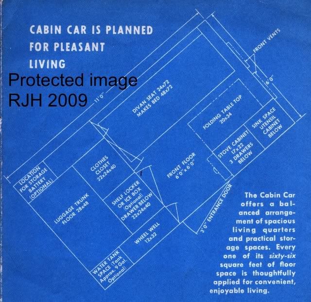

Postby 48Rob » Mon Dec 15, 2014 7:43 pm
Kerry,
The original cabin car was 6' x 11', but the modern version I built is 7' wide x 12' long.
The body hangs over/covers the wheels which allows a lot more room inside.
Having fenders on the outside does make it a lot easier to see around when towing.
Rob

Postby 48Rob » Wed Dec 17, 2014 5:32 am
Judy,
I understand.
At 6'-2 I like to stretch out as well. In a regular tear with the mattress as the floor, not much you can do other than lay down, or sit up slightly.
In the Cabin car (my design at least) the bed is on a platform, much like a bed at home. The floor is "dropped" or recessed 3.5"
These things combined allow you to sit straight up with your feet on the floor.
Standing straight up isn't possible, it is more a bent position, but if you chart the amount of time you sit, as opposed to stand while inside a camper, you'll find that 90+ percent is spent sitting, not standing (this doesn't count sleeping).
As with most things in life, camping is a matter of personal compromises! :thumbsup:
I really like having the extra floor space, and the bathroom.
I can stand up outside ;)
Rob
