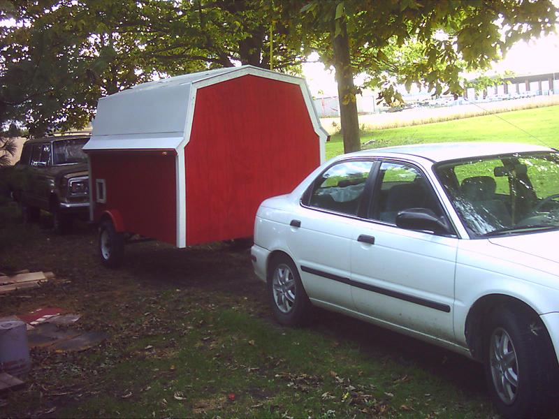

My barn is about as aerodynamic as a :thinking: ah ah BARN !
I have no problem towing even with a 1200 cc Suzuki Esteem at state highway speeds. My answer is build what you want and take the scenic roads less traveled at a more enjoyable speed.
