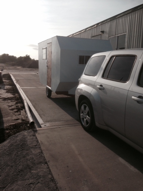

Day 68 of my build,
I did a 30 mile road test of my Weekender-XL today, with a visit to the scales. The inside is unfinished, so I still have the foam board and 1/16" paneling to install, a single bed, counter and some storage, plus the sundry lights and 12v-115 vac power.
My HHR pulled it just fine. The mpg readout was showing 15mpg to 25mpg. It's very sensitive to a little bit of grade, due to my 2.2L engine. I think 17-18mpg is going to be the best I can hope for. My 2014 Dodge minvan with the 3.8L engine and 6 speed would be a better tow vehicle. I think it would average 22mpg- about 5mpg less than normal.
I'll entertain some guesses now as to my empty weight-- :thinking:
Its a HF 1195lb chassis, 3/8" plywood skin, 1/2" plywood floor. I stretched the frame 6" in front of the axle= 102" long trailer, w/ a 60/40 distribution. measurements= outside is 127" long, outside width is 68" and the inside ceiling height is 61.5"
It pulled easily with no surprises. I expect it to do OK with another 200lbs added to complete the camper- as long as I monitor the tongue weight. It came out to almost exactly a 15% hitch weight. I feel that I met the weight goals for my extra large Weekender inspired design.
leaving the scales-
back home,
Mark

How much can I expect the trailer springs to go down when I am finished and ready to travel? I need to go down about 1" lower on the springs to have a level ride. I guess I could stack 5 or 6 concrete blocks over the axle and see what happens-- except I only have 2 blocks!

I just remembered the trailer was level when it was just a frame, so I might look into getting a set of air bladders for the rear coil springs- I think that would work good.

Regarding the trailer not towing level...have you done the calculations to make sure you have the correct rise/drop ball hitch? From the pictures it looks like the trailer tongue needs to be a little higher at the hitch.

When the camper is done and loaded, that is when I have to make final hitch adjustments. It was level ( by accident) when I started with a bare frame.
I am 68" tall and I only have to tilt my head down inside- no back stooping or knee bending.
the width worked out with my mirrors. I can see past the side walls- and I can see an impatient driver through the back window trying to pass me.
