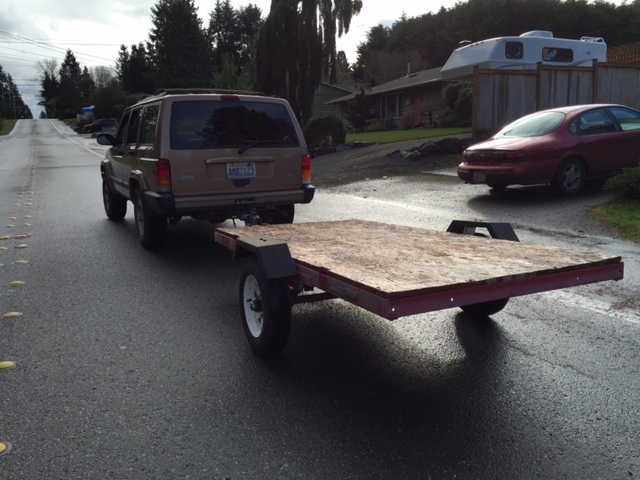

Postby jasonneuerburg » Mon Feb 09, 2015 7:00 pm
thanks for the feedback everyone. I have been browsing the forum for a few weeks so I have a little bit of reading done. Ended up finding a used trailer today. Also which version is the weekender? Is that the standard but with straight lines instead of curves?
