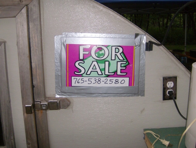

Postby bobhenry » Wed Apr 01, 2015 1:34 pm
Still have the one in the picture for sale :D
Have had a couple nibbles at $1200.00 " READY TO CAMP".
Hell I will even throw in the blankets
