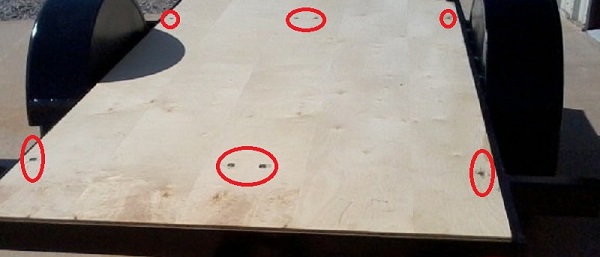

Not if you do build it in two stages. I was building a 3/4" plywood structure (bought 5 or six sheets of great pre-sanded 3/4" ply for $125), but I started out with one sheet of 1/2" birch plywood I had stored in one of my outbuildings for 10-12 years. I bolted it to the frame (on the interior frame members, not on the perimeter ones) with eight 3/8" carriage bolts.

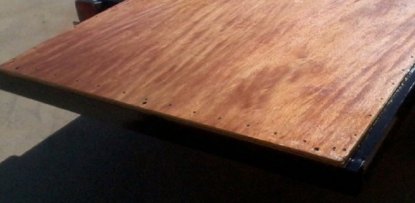

We slowly "stitched" the pieces together, going forward along the edges. The Tek screws (we use 30-40? in all) went thru both layers of wood into the perimeter metal frame. As I was rolling out the excess glue, I used my body weight to maintain pressure on the completed areas. I maintained the pressure, later, with bags of goat feed, remaining on top for a week, to cure. Finally, I polyurethaned the luan (3-4 coats?) and auto-body undercoated the trailer floor. Even without the main structure on top, this floor can't move!
