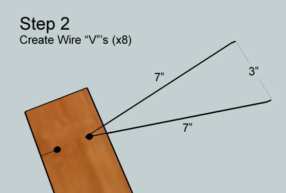

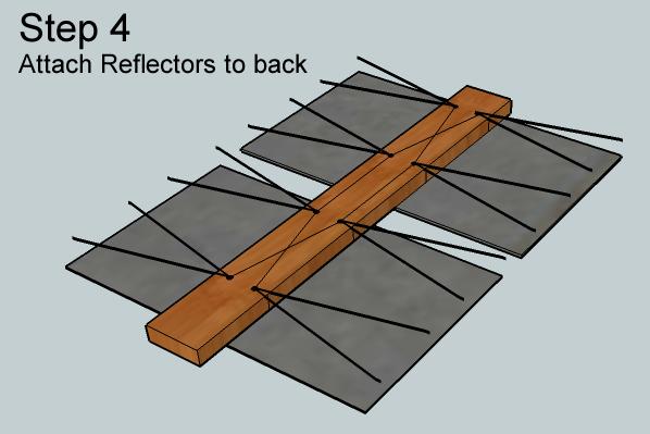

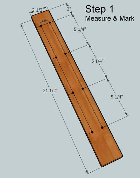

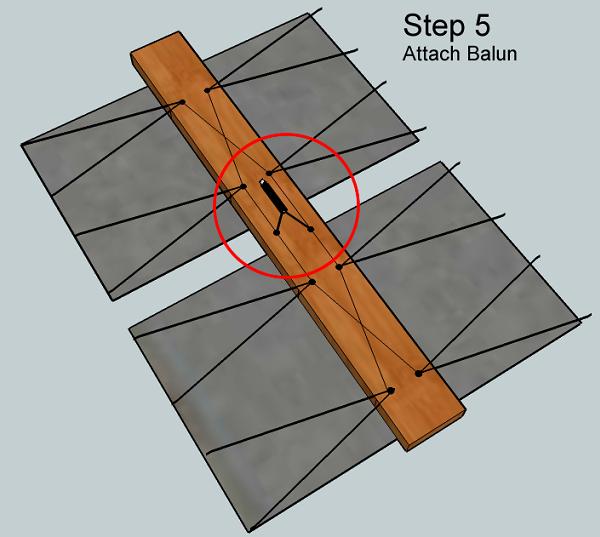

It sounds like it still would be aimed to get the best signal. For a really low cost antenna this works really good.
http://www.tvantennaplans.com/

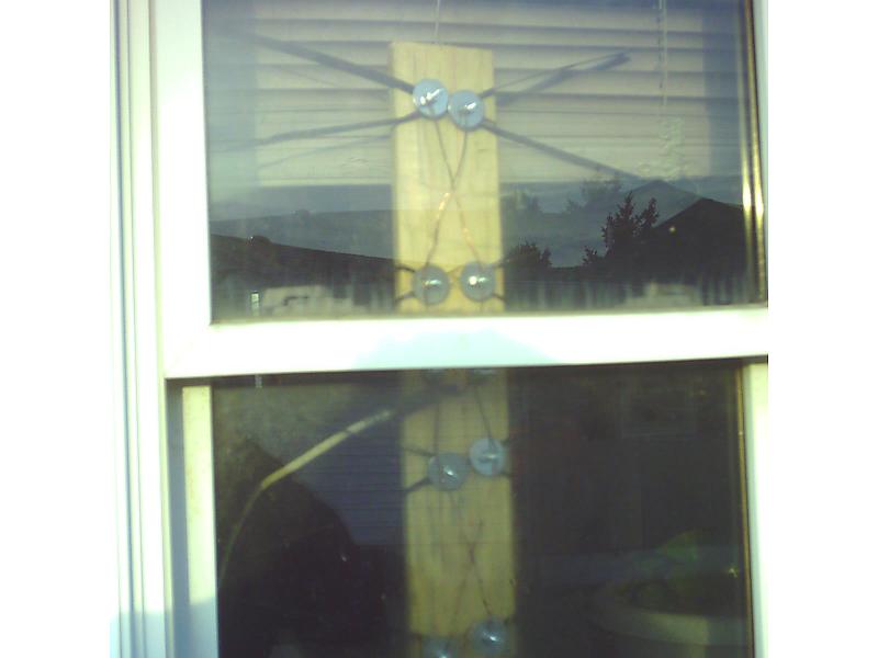

I have been using a redneck antenna since 2008 at home and on an occasional camping trip.
