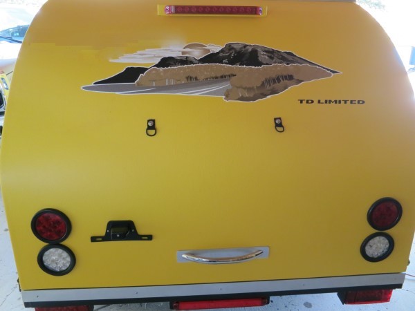

I went with lights on the trailer down low, More lights plus backup light higher up in the hatch and a 3rd brake light even higher up. Since my trailer is over 80" wide it has the over 80" lower lights in the center and I added fender lights for when someone is passing or off to the side. I also put reflectors along the top on the sides, and painted it bright yellow.
The specifications are usually the minimum. I didn't want to get hit and didn't design in a bumper so I thought lights the more the better. No one said a thing when I registered it. Now all I have to worry about is looky-loos focusing too much on the trailer and not on their driving.

I put a third brake light at the top of my hatch like on kayakdlk's tear.
Mine was from Frank Bear, it's a four wire design so the left or right side will blink when turning. Just be aware that the boss for the wires is off-center, so measure twice, drill once. :oops:
My brake/turn lights are each 10 LEDs like these, you can't miss them if you're anywhere behind the trailer.
Also, make sure the sides of your trailer are well lit so people do not merge into you. I used 4 LED units

There are brake lights on each side on the bottom of the frame, one on each side higher up in the galley hatch and a single center red brake light even higher up for a total of 5 brake lights. I have a turn lights on bottom frame one each side, and backup lights one each side in the galley hatch. I figure letting everyone know I was braking was most important
