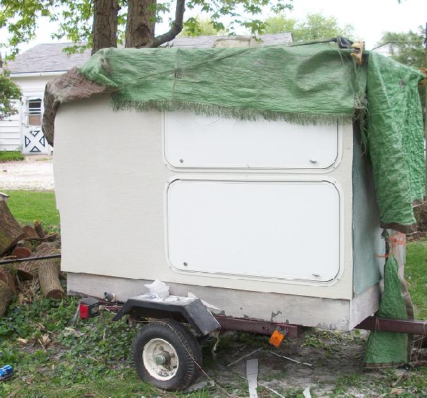

I thought I would add a few shots of my spacious shop during 5 different builds
Same shop with the same leaky roof.
All the builds turned out just fine.
