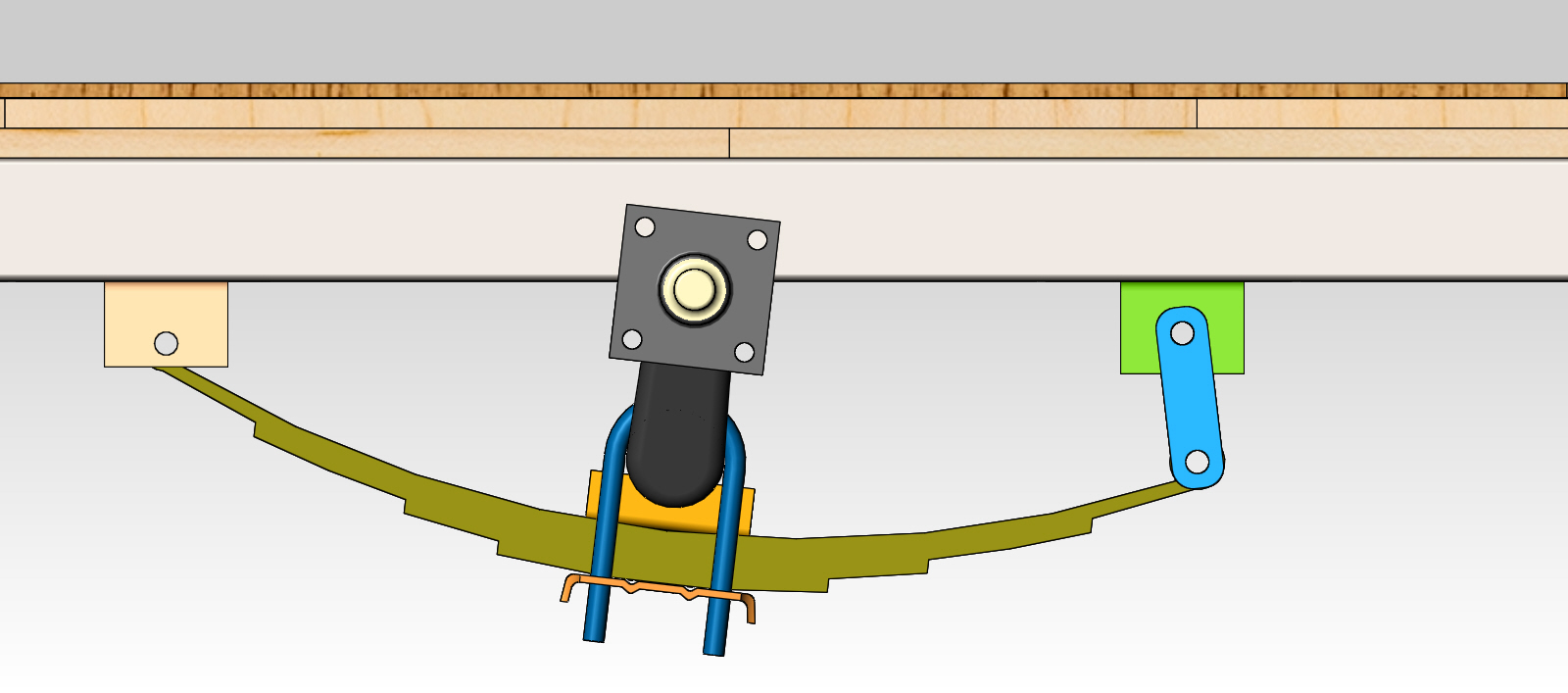

I purchased an axle kit that does not have the spring seats pre-welded in place. The welding is not an issue as I will be welding the entire frame, but the question is the angle of the spring seats. This is an image out of the 3D software that I am using and it shows the spring seats parallel to the brake brackets. From the information that I can find, this is correct. But when I mounted the axle in CAD the angle of the 4 inch drop looks excessive. Should the spring seats be welded in place so that they are parallel to the frame? Or, when the trailer is loaded will it all line up correctly?
Thanks for your thoughts,
Scott

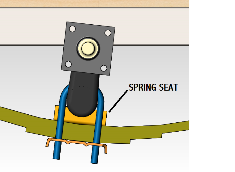

I'm confused what you mean by spring seat.
Do you mean the axle pad that gos between the spring and axle or the spring hangers?

Yes, the axle pad, I was not sure what it is called exactly.

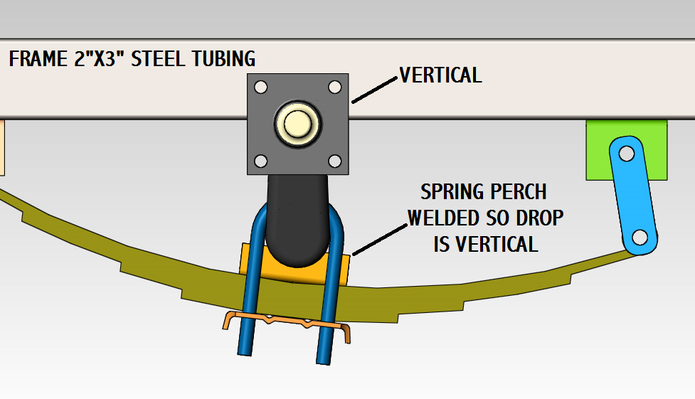

It is called a spring perch.
I do mine so they are parallel with the frame when loaded.
On a straight axle with no camber built in, it isn't critical, unless you cover the holes for the electric brake wires.
For a drop axle, you want the beam parallel to the road when loaded or your spindle/wheel mount will be forward or backward and can change toe in.
Rob

Thanks for the replies. My axle is straight without any camber. This is an image of the revised angle, does this look correct?

That looks much better.
As Dales suggested, waiting until you are finished, or placing the approximate amount of weight on it will change the angle from just hanging while jacked up.
Rob
