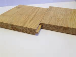

Tongue and grove siding was the preferred sheathing method up until the introduction of plywood.
The framing method (the bones) remain unchanged. You will need to hold onto your wallet when you purchase t&g now days
It has become a rather expensive option.
Here is what wikipedia had to say .................
A strong joint, the tongue and groove joint is widely used for re-entrant angles. The effect of wood shrinkage is concealed when the joint is beaded or otherwise moulded.[1] In expensive cabinet work, glued dovetail and multiple tongue and groove are used.
Tongue and groove is a method of fitting similar objects together, edge to edge, used mainly with wood, in flooring, parquetry, panelling, and similar constructions. Tongue and groove joints allow two flat pieces to be joined strongly together to make a single flat surface. Before plywood became common, tongue and groove boards were also used for sheathing buildings and to construct concrete formwork.
Each piece has a slot (the groove) cut all along one edge, and a thin, deep ridge (the tongue) on the opposite edge. The tongue projects a little less than the depth of the groove. Two or more pieces thus fit together closely. The joint is not normally glued, as shrinkage would then pull the tongue off.
In another assembly method, the pieces are end-matched. This method eliminates the need for mitre joints, face nailing, and the use of joints on 16-inch (410 mm) or 24-inch (610 mm) centres of conventional framing.
For many uses, tongue and groove boards have been rendered obsolete by the introduction of plywood and later composite wood boards, but the method is still used in higher-quality flooring. Plywood may also be tongued all round to fit it flush into a framed structure, and plywood for sub-floors used in platform framing is often supplied with tongue and groove edges

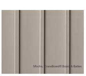

The sideing is called board and batten, if I understood you correctly. The boards are put up and the gap between is covered with a small board, the batten. This could be both the sideing and the frameing on a small shed. Or a camping trailer.

Board and batten runs vertically . Image
It is clear in the vardo build pictures the tongue and grove siding is running horizontally. What may be confusing the issue is they have chosen to leave the exoskeleton framing exposed on the outside to make it look more like a wagon and less like a house.

Actually horizontal or vertical orientation has nothing to do with siding type/construction.
Board and batten construction consist of parallel "boards", usually butt-jointed together, with "battens" nailed/affixed over the butt joints. Tongue and groove is just board to board with no batten. Either can be horizontal, vertical, or angled.
And then there is lap siding, shiplap siding and other variations of the theme.

My understanding of battens is that their sole function is to cover seams, and that the framing of a board and batten wall is still interior studs. In the depicted construction, the exterior members are framing studs (just small ones), and don't run the length of seams. Otherwise I would agree about the label. But it could be that the definition of battens is broader than I'm aware of.

Board and batten is typically installed over a framed wall. If the board and batten is to be installed vertically (or any other siding for that matter) and the framing is vertical, then either the framing is sheathed in plywood or 1x3 or 1x4 strapping is nailed horizontally to the framing to provide a surface for nailing the siding.
Battens are not intended to be structural but they do contribute the strength of the wall panel assembly. Often the primary reason to use battens is mostly aesthetic to provide shadow lines to break up a large expanse of a flat panel.
