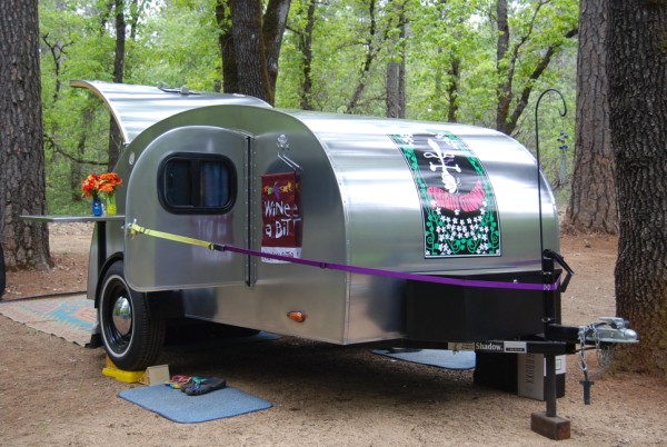

I'm trusting that the photo of my teardrop will come up along with my message, so you can see what it looks like. It is made of aluminum (not by me) and I want to have a name plate made so I can name the trailer after my dear departed dog "Izzie". It will either say "Izzie" or "The Izzie".
What is the best way to get something to permanently attach? Rivets? I don't think any glue will stand up to the brutal sun in So Cal. Also, since I did not make the trailer, if we used rivets from the outside, would they pop through on the inside? Of course there are many variables, but I guess the question is how much space is between the outside and inside, on average? The inside is made of some wood paneling.
