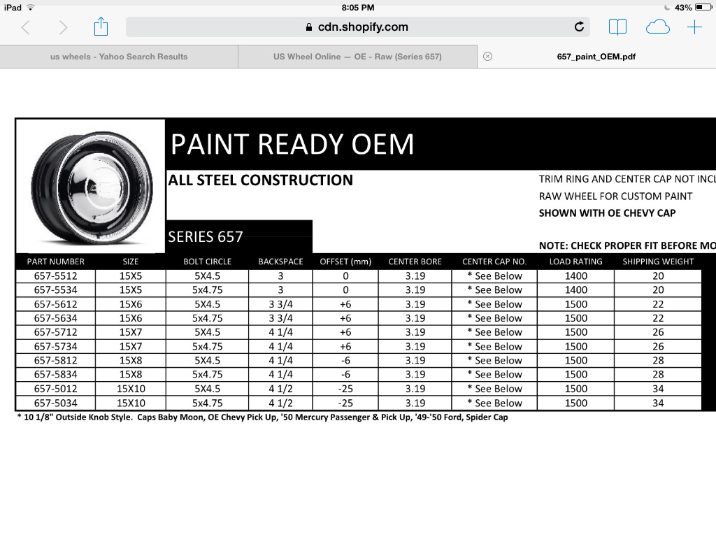

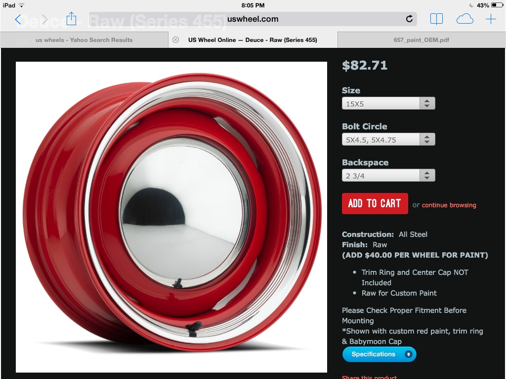

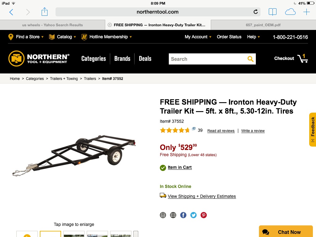

I'm trying to get a starting point. I like this trailer and I like these wheels. I know both are 5 1/2 by 4 bolt pattern. I know I would have to remove the fenders. However how will I know the tire or new wheel won't hit the frame. Is there a spec for that?

Its all about offset and back space ... Generally trailer wheels have "0" (zero) offset meaning the bolting surface is centered in width of rim (wheel)... Back space is the distance from rear edge or RIM to bolting surface.... Usually a 3 inch back space means the wheels bolting surface is 3 inches for from edge of rim and then allowing at least 1 inch for tire bulge and some free space you need probable 5 tp 5-1/2 inch minim, space between hub bolting surface and trailer wall for clearance...
If you are close and need a little more clearance you may get a way with wheel spacers, but that is sort of a risky option...
And generally trailer wheels are designed differently for offset then passenger car wheel....

So the wheel above seems to show specs at 0 offset and 3 inch backspace.
Do I just need to ask the place selling the trailer if the trailer will accommodate those specs?

I didn't think it would be this difficult to begin. Do you think most tears with nice rims are custom built? In feel I'm building my trailer around a wheel :thinking: A re custom built trailers welded or bolted together. I don't weld.

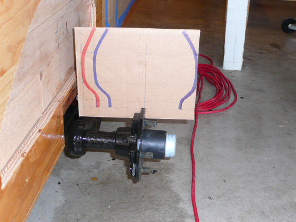

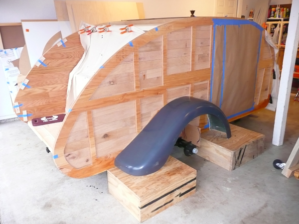

I don't want to confuse things further but there is another factor to consider. It took me awhile to think through it but if I was able to do can you. The other factor to consider is the type of fender you are using. I wanted my wheel and tires to visually "fill" the fender opening so I selected a wheel and tire size that would do that. Besides making sure there was adequate clearance between the tire and sidewall, I wanted to make sure there wasn't too much clearance between the sidewalk and outside edge of the fender opening.
The math became too much for me so I ended up making some cardboard templates of the wheel and tire to see if everything would work. I'll post a picture later when I get to a computer.
Re: Will this trailer and wheels work together?
Postby Retroguy » Fri Jul 31, 2015 6:04 am
I appreciate your help. Did you have your fender custom made?
Retroguy
Posts: 23
Joined: Mon Jul 20, 2015 4:29 pm
Location: Rhode Island USA
Postby aggie79 » Fri Jul 31, 2015 8:08 am
aggie79 wrote:I don't want to confuse things further but there is another factor to consider. It took me awhile to think through it but if I was able to do can you. The other factor to consider is the type of fender you are using. I wanted my wheel and tires to visually "fill" the fender opening so I selected a wheel and tire size that would do that. Besides making sure there was adequate clearance between the tire and sidewall, I wanted to make sure there wasn't too much clearance between the sidewalk and outside edge of the fender opening.
Here are a couple of pictures of my high-tech wheel mock-up. I made a few cardboard templates with different front spacing. (I wanted the tire to be close to the outer edge of the fender well.) The first picture is one the cardboard templates. It has two wheel/tire widths with the same front spacing (but different offsets and back spacings.)
It's a little hard to see, but this picture shows the template with the fender roughly in place.
