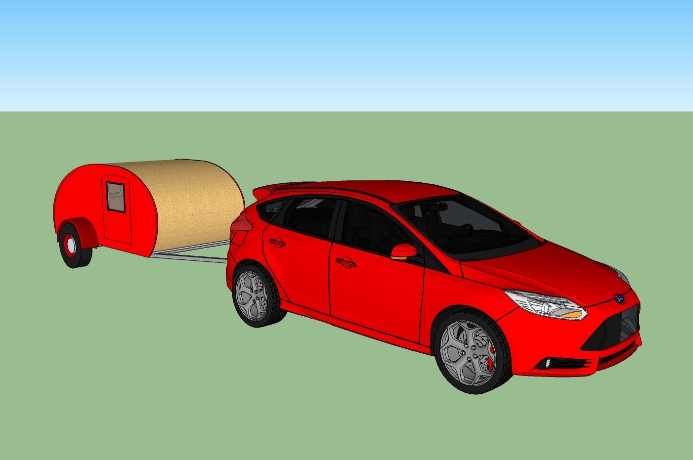

Postby friz » Sun Sep 13, 2015 7:07 pm
Playing with sketchup.

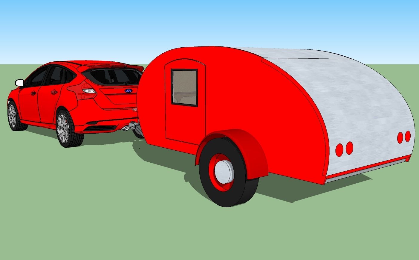

Re: I think I figured out my build
Postby friz » Mon Sep 14, 2015 12:47 am
Playing some more. Alum skinned rook and corvette tail lights.

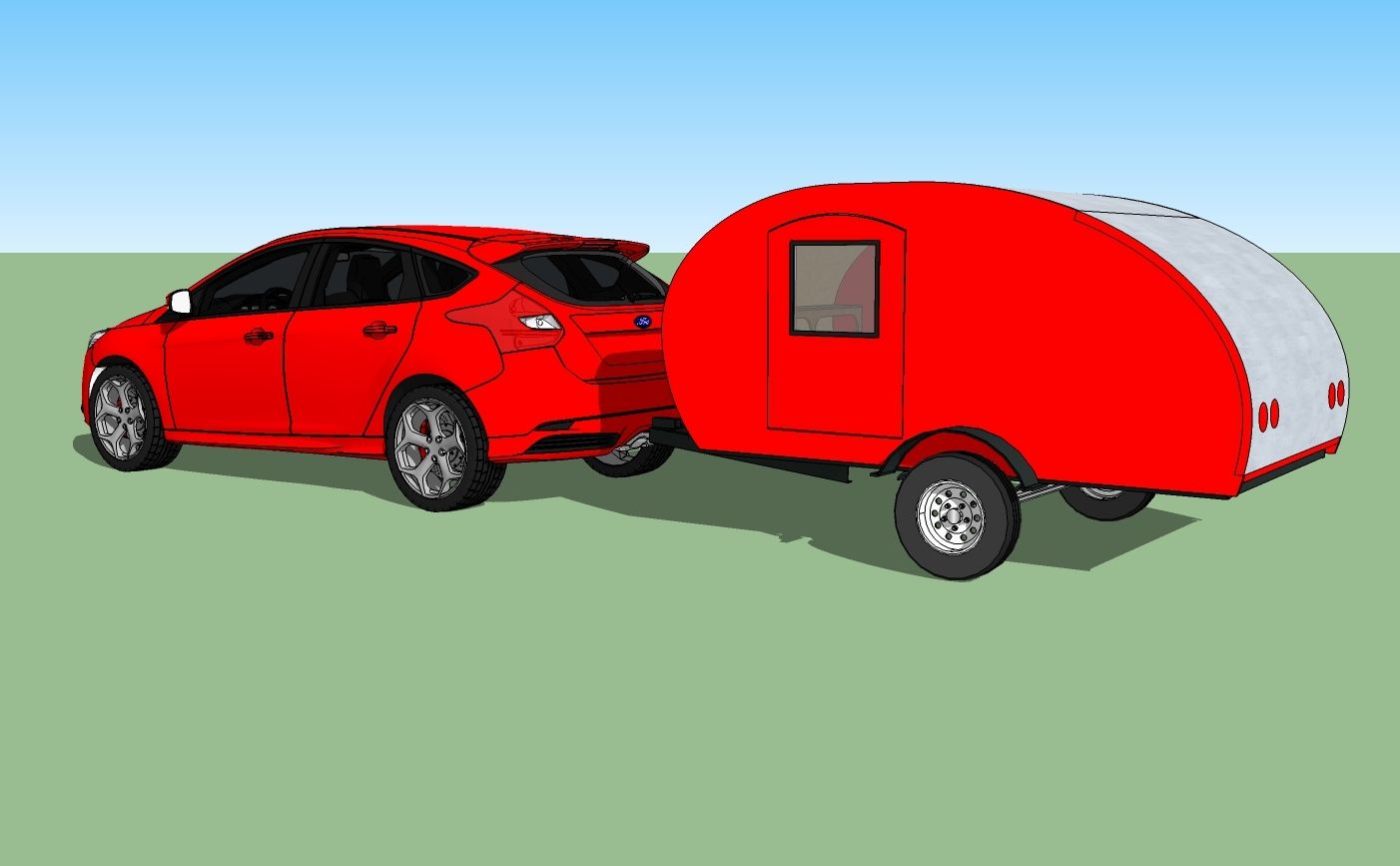

Postby friz » Mon Sep 14, 2015 11:54 pm
I corrected the scale of my model and placed it on the model of the trailer I plan to use.
Postby noseoil » Tue Sep 15, 2015 7:29 am
Fritz, I like it! Looks like a nice clean package & even matches the paint! I'm a bit confused, it's going to be painted to match, yes? Not a traditional "woody" look with exposed wood trim, correct?
Postby friz » Tue Sep 15, 2015 9:23 am
I have yet to model the wood trim. Soon
Postby friz » Tue Sep 15, 2015 9:28 am
I also need to refine some of the interior dimensions. I don't think my mattress will fit as it is now.
