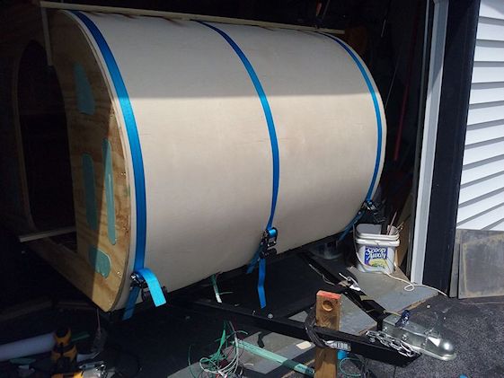

Postby TomMaj » Fri Sep 18, 2015 9:25 am
1/8" baltic birch here too, two layers. No pre-bending necessary. Glue up the spars or ply surface, crank down on the ratchet straps, and let it dry till the morning. On bottom picture,you can see a 1x2 and shims clamped on top to hold the plywood edge tight.

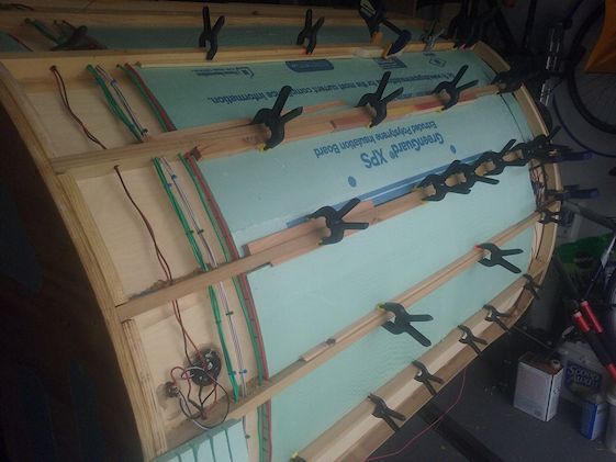

My ceilings are somewhat of a SIP––structural integrated panel. Is an 1/8" ply on the ceiling, spars about every 10" with blocked in foam, and then another 1/8" layer of ply. Both layers of plywood are glued and attached with 1/4" (pneumatic) crown staples to the spars. And the foam is also glued to both the ceiling and the "roof." I use Steve Fredrick's inside-out build method. It's strong, warm, and quiet.

TerryB89 wrote:Sweet Thank you both ! So it's just glued down no screws or nails ?
I used screws on the end at the very bottom spar. Also drove in 2 screws at top to keep the wood from migrating during the clamping glue dry period, and I removed them afterward. Lots of Loctite Pl3X on the spars and edges, and paint on Titebond 2 between the 2 ply sheets.
This is what I did as well, once the glue dried, I actually removed the staples. Then I coated the entire thing in epoxy, (fiberglass tape on the edges and seams) and painted it.
