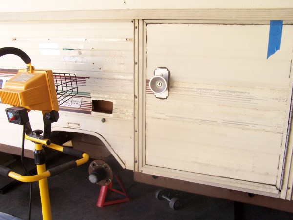

After trying numerous liquid solvents, nothing would touch the old dried out decals. Their only use is to clean up the glue after removing the decal. I tried a heat gun and it worked pretty well but it was cumbersome having to change hands constantly as I scraped. I found that putting a halogen work lamp up against the side and moving it slowly in the direction that I was working seemed to do the best. I also found that a simple single edge razor blade scraper would get under the decals without damaging the metal. The razor blade worked well on flat surfaces but it took the clip blade of my pocket knife to get the angled areas along the corrugations. This looks like the best way to do it so far but it is going to be a long, slow process. I'm not trying to save the paint as it will all get sanded and re-painted later.

After a lot of tedious time with the razor blade scraper and knife, I decided to try something different. I did a test section using a small propane torch and moving it continuously with a low flame. I could actually see the decal bubbling from the heat. As long as I scraped while it was still hot, it would easily come right off, saving a lot of time and effort. This produced a few sooty spots where the decal actually burned a little, but those spots cleaned up nicely with a little sanding. After working about a square foot area and cleaning it up, there was absolutely no damage to the metal skin. Guess I'll keep using this method for now.
