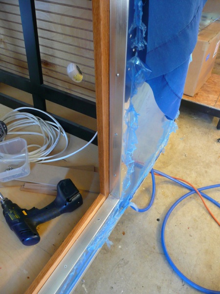

I agree on both points. While doors are not too difficult to construct - once you get your mind around how to build them - they do take a considerable amount of time in fitting the door to opening, trim work, seals, hinges, locksets, etc.

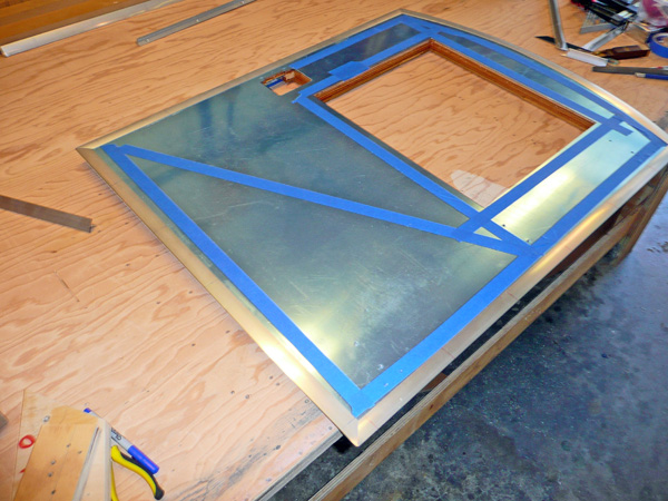

I built my own doors and windows, with no expensive trim or hardware. The classic tear door latches are about the most expensive part of my whole tear.
