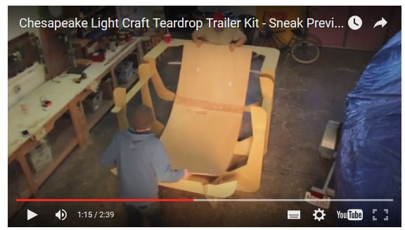

Postby angib » Tue Jan 19, 2016 10:47 am
That seems a design that is being clever just for the sake of it.
Just look at the assembly technique, where an 'negative' mould of framing is produced to hold the body panels in shape before they are glassed together:
Similarly, making doors with a knuckle between top and bottom halves seems an excellent way of making sure they won't fit the body exactly.

Postby p40whk » Tue Jan 19, 2016 10:50 am
angib wrote:That seems a design that is being clever just for the sake of it.
Most of their boats are built this way and there are quite a lot of them out on the water. It doesn't surprise me that they designed it to be built this way but what does surprise me is that there isn't much in the way of technique from this site applied to their design. Kind of makes you think they didn't do a lot of research.

Postby Esteban » Sun Jan 24, 2016 7:21 pm
Watched their video and immediately saw that the cabin doors don't snugly fit with the cabin's curvature. It looks to me like they'd be very hard to seal out air and water leaks. The doors were less curved (flatter) than the side cabin walls. They were very noticeably mismatched with the cabin at the top and bottom. I'm not favorably impressed by their teardrop design.

Postby rowerwet » Mon Jan 25, 2016 12:27 pm
Already posted viewtopic.php?f=2&t=65136
I let John Harris know about the issues we've noticed, he says the camper on the road is insulated, the other issues will be addressed with a new bigger design, down the road. :thinking:
Seems like a lot of first time builders will be disappointed, and that is a bit of money to not be happy with.
