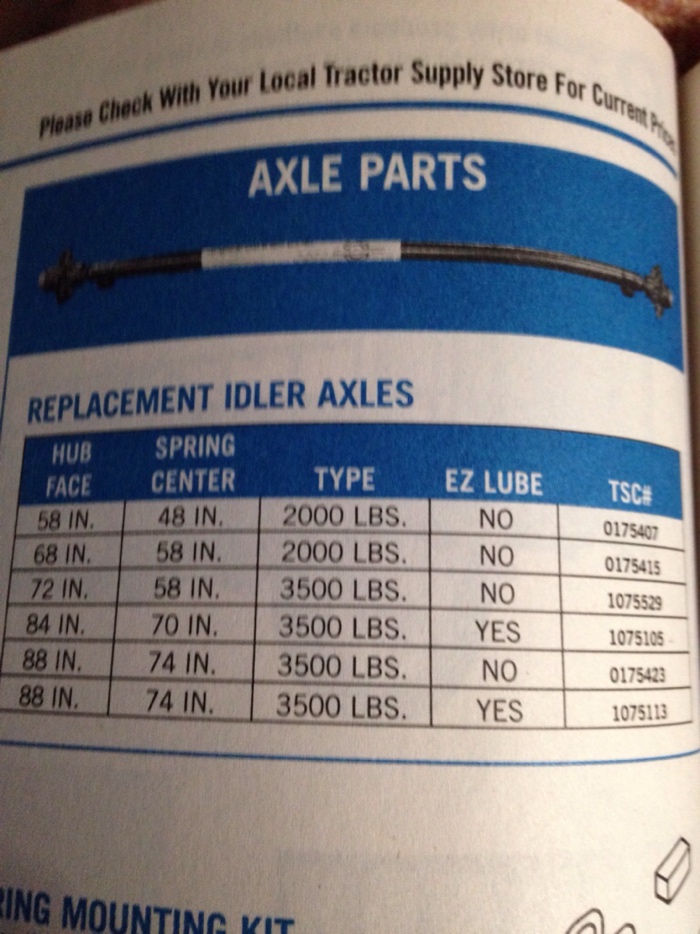

You don't want the tire's under the trailer deck? But outside of side walls of the trailer?
Here is a pic of common axles with overall length and spring perch.

Postby Bald Cypress » Mon Feb 29, 2016 7:25 pm
Alright, looks like the 68 " will do just fine.
I probably should have looked a bit harder before asking my question.
Thank you for the answer.
